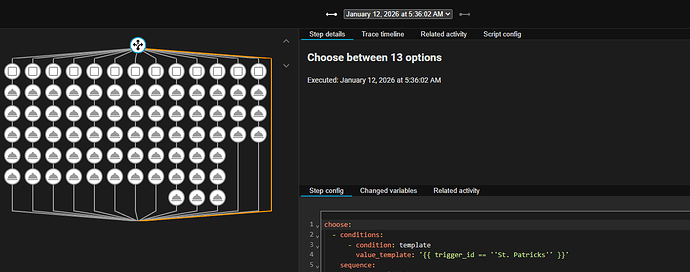

Passing Trigger ID to script issue
I’m having a brain fart trying to gey this to work. I started consolidating my automations for a cleaner look. Any help is appreciated, thanks.

  - action: script.holiday_lights_on
    metadata: {}
      trigger_id: "{{ trigger.id }}"

  - choose:
      - conditions:
          - condition: template
            value_template: "{{ trigger.id == 'St. Patricks' }}"

Traces:
how are you faking the day in question and which one?
edit: go to developer toolsactions and explicitly call that script with the trigger_id == 'Mother and see what happens (the problem may not be in the script).
If you go to the first step of the script in the trace, and then press Changed variables what does it show as value for trigger_id?
ok, found the issue… was a caching issue as I had several Dev Tool windows open. Closed them all and restarted HA and all is working now…
It was looking at an older script (script.holiday_lights_on) and not the current one (script.outdoor_lights)… only noticed when I went to actions… SMDH that I didn’t see it earlier.

You may wish to review the following description of how often a template is evaluated when it employs the now() function.
It’s evaluated once a minute so that’s 1440 times a day (for each one of the eleven Template Triggers in your automation) or just over a half-million times per year. I think it’s fair to say that one only needs to check once a day, to determine if the current day is a holiday, rather than 1440 times.
A simple way to do that is to use a Trigger-based Template Sensor that (minimally) triggers at 00:00 and computes/reports if the current day is a holiday. The automation triggers at sunset and uses the sensor’s holiday value (if any) to control lighting.
@123
Yep, agreed and will do that or I can just switch the automation around to look if it is sunset first…
Bit of a stupid question, but is there a reason why you need to roll your own code for holidays when the Holiday integration exists?
The Holidays integration and the Google Calendar integration provide more holidays (Cinco de Mayo, Tax Day, etc.) then I need and I know I can filter them. I am doing this for outdoors lighting displays and want them on prior to (approx. 2 days before the holiday) and depending on the holiday, several days after it… run this in developer tools actions to see what I mean…
action: calendar.get_events
  entity_id: calendar.holidays_in_the_us
  duration:
    days: >-
      {{ ( as_datetime(now().year ~ '-12-31') | as_datetime | as_local -
      now()).days + 1 }}
