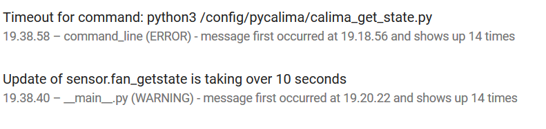

Thanks for sharing your Calima setup. I finally got it working… sort of. I think my Ruuvitag BLE beacon add-on was interfering with connection to Calima fan. As soon as I stopped Ruuvitag add-on, my command line sensor got values from python script. The problem now is that I cannot use Ruuvitag add-on if I want to control Calima fan. And my log is bloated with errors. Here’s my setup.
sensors.yaml
- platform: command_line
command: "python3 /config/pycalima/calima_get_state.py"
value_template: '{{ value }}'
scan_interval: 60
command_timeout: 55
