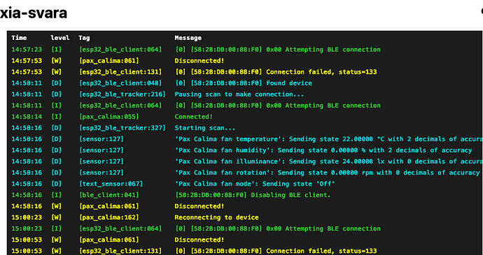

Thing is that it is showing no real humidity but some normalized value. Usually, it is 0% unless you shower (or probably spray water another way), then you will see that value is growing. Probably it uses a number of particles or something.
That is how this looks for my fan:
Spikes it is when somebody was showering and you can see that humidity ventilation started at the same time (purple value on the top diagram.

Keep in mind that for now, it is working only as sensors no fan control is available. It is much more difficult than I expected. You need to know your fan MAC address to connect BT to your Vent Axia Svara. You can get it from a sticker on the control block: https://www.vent-axia.com/sites/default/files/svara_pin_code_0.pdf
You can also save a pin it is not needed now but maybe will be needed in the future for controlling the fan.
You can use this custom component: GitHub - paveldn/esphome-calima
There is vent.yaml sample config file. You will need to make secrets.yaml file like this:
