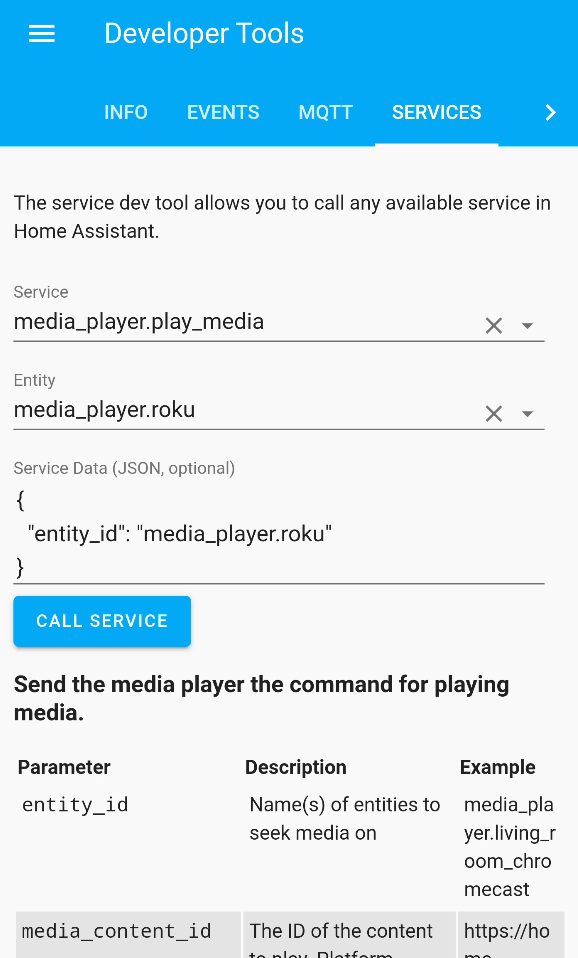

In HA if you go to Developer Tools - Services you can select your alarm_arm_home (if that is what it is called). From here it should show you the required service data. Additionally below it will show other parameters you can set as well.
You can then copy this to Node Red as the data - I have been doing this in a template node first as I find it easier to modify and just leave the data field blank in the service call (it inherits the payload from the template node). But do whatever works best for you!
