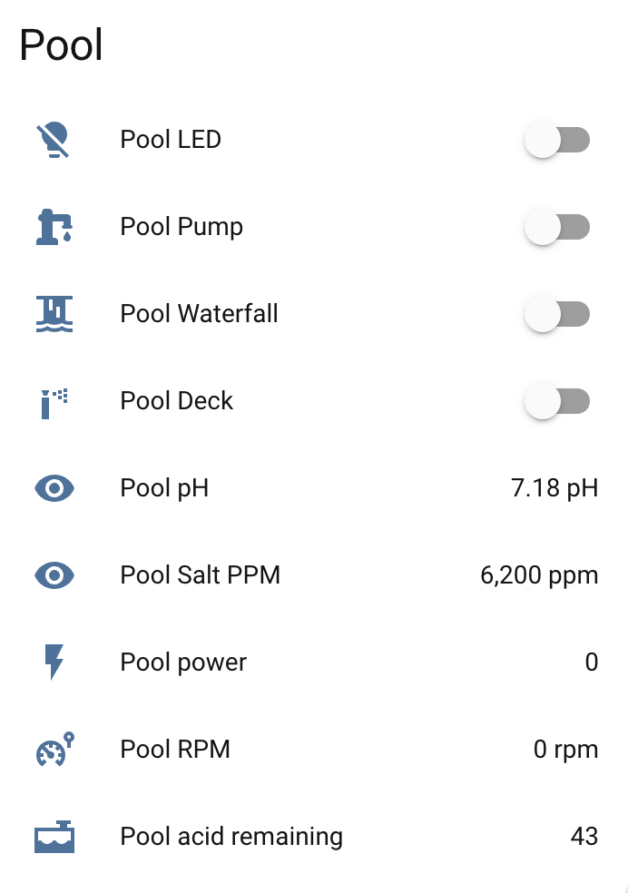

I rolled my own integration with a Raspberry Pi Zero + RS-485 hat. That talks to my Pentair Intellichlor40 and the Intelliflow pump. Someone else reverse engineered the serial commands and posted them to GitHub. Additionally, I have an Atlas Scientific ph probe in i2c mode connected to the Pi. I wrote a python script to interface with for both buses and sends status to home assistant via MQTT.I have a separate esp-home like device that controls a peralstatic pump with a relay to inject the pool with acid, based upon the ph probe value read every morning. It also speaks MQTT. Lastly, there is a 3rd esp-home like device (pool deck) that controls a 24v ac sprinkler valve hooked up to sprinklers that shower the pool deck with water to cool it off. Useful for those days > 100f/43c.

This approach was not for the feint of heart. I’ve had a lot of gremlins over the years I’ve had to fix. It’s pretty solid now. I used to have an ORP probe to keep track chlorine levels. I gave up after a couple of years as the probe was not lasting > 1 year and I’m able to keep chlorine levels stable since I use the Intellichlor40.
