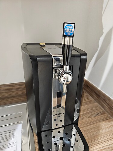

I have a PD Pro on order and am looking forward to trying to create an integration for it once it arrives. I made my PD Standard pretty smart with the help of an energy plug and some HA magic. The PD unit/machine lives inside a cupboard, and after little modification I was able to connect the keg adapter to a beer tap I fitted on top of the worktop. It looks fantastic and works amazingly well.
Leveraging a counter helper, which I reset with each keg change, I’m able to track how many pints are remaining by detecting the energy spikes from the smart plug when pulling a beer.
I also use the new Todo list (2023.11) to track the kegs, I have in stock. Using an automation that catches the event when a todo item is marked as completed, I set that item as the current keg which I use to show the medallions for that beer through a Mushroom card. This looks great on the Android Panels we have installed on the walls.
The last piece I’ve had fun working on is a 2" display, powered by a RP2040 to show the medallion of the current keg on the beer tap. I have a working solution but am exploring alternatives, as I’ve also acquired a 4" LCD. I need to work on a cone like enclosure/mount for it to live on top of the beer tap preferably out of stainless steel to blend in with it too.
Happy to share more for those interested to learning more in what I’ve done.

That looks absolutely awesome James!

Thats amazing work, i just picked up an original one today which is second hand.
With the remaining left is that calculating whole pints only? Or is it able to calculate halves too? (I.e if pumping for a shorter time period than a whole pint takes)
With the medalion you could 3d print something similar to this which couid put it on the handle.
Hi James, how did you do the counter-top tap? I played with this a couple of years ago, trying to do the same. Any more pics / info you can provide would be great please!
