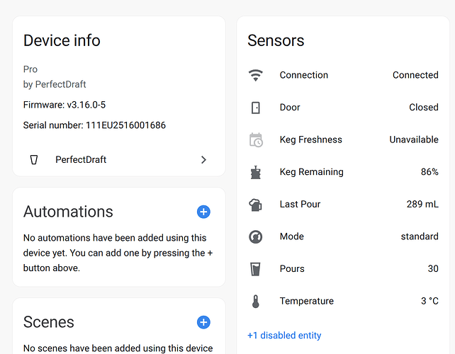

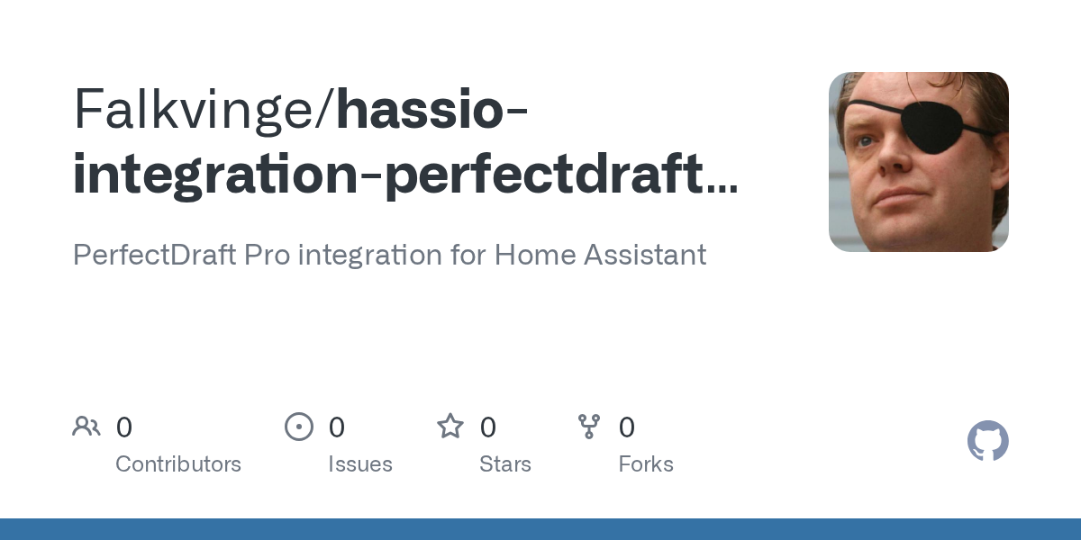

I have made a working integration from scratch, using some of the hints found in this thread.
Or rather, Claude Code made it through relentless hammering at the problem for well over ten hours (check the extensive DISCOVERY.md!).
Regardless, there’s now a working PerfectDraft Pro integration. Add as custom repo to HACS.
I’m sure there are things to be fixed. But this comes online immediately and reports values. You need to enter your PerfectDraft email, password, and generate a token once (a 30-second procedure that is well documented step by step) to install.
This integration (mine) correctly detects insertion of a new keg and resets the (integration’s) freshness timer to 30 days. Just inserted a new keg and it works.

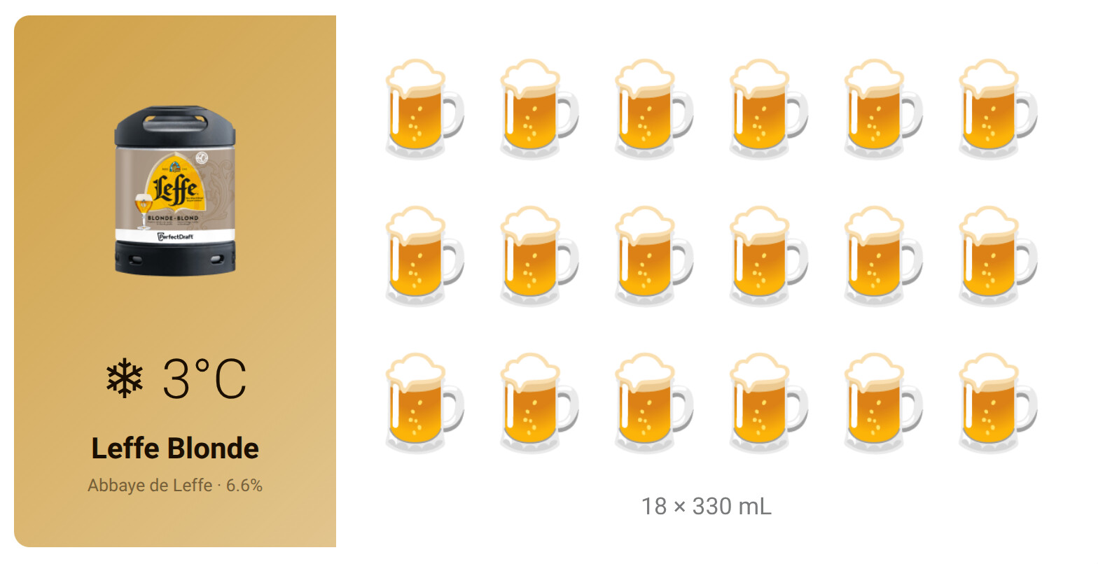

Now also with a companion card that displays the current beer, the temperature, and how many glasses are left. Beer selection and glass sizes configurable. Alerts on freshness expiry approaching.

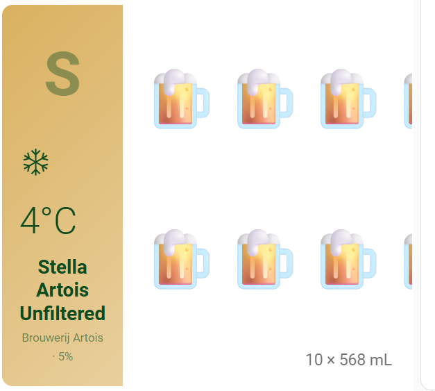

My Card is being cut off, is there any way of resosolving that?
There’s already a “percent left” sensor in the integration which the card uses (“Keg Remaining” in the screenshot above). You can multiply this by the six-liter contents of a PerfectDraft keg, it will give you the volume remaining. This is how the card works (and then it divides that by the glass volume to get the remaining glass count).
I have not changed the Mode, so I haven’t tested that part. Does it change in the app? The integration should be showing the same data as the app.
I will see if there’s easy changes to be made to accommodate other screen sizes for the card. What is the display you are using, or the format of your card? I made it for myself first, so every new user will have a new size/display requirement, and eventually, it’ll be flexible enough, I guess?
Thanks for the follow up. The mode was changing in the app but just not in HA. The screenshot was taken from my the standard Sidebar dash in HA, but using the iOS app it works great. One thing I haven’t been able to get working is the beer keg image. Are you able to show me how you how you have done it on the Leffe Blonde keg image? Thanks

The beer keg images were collected as product images from various stores (copyright case law permits this clearly for product images when they are used to refer to the product); not all images were available. For example, Leffe Noël / Leffe Winter isn’t in season at the moment. More images will be added as they simply come back into season.
Would it be possible to add the image for Stella
Artois Unfiltered? Thanks
I am adding significantly more display options at this time, which should address your card's min-width being larger than your viewport. Release within the hour. Also looking for more keg images.

Fits narrow cards
The emoji grid is now width-tolerant — it shrinks to fit instead of overflowing/cropping on narrow placements. New advanced options: matrix_columns (auto or a fixed count) and max_matrix_width.
