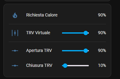

Hello everyone,
while I really appreciate the original post, with all the descriptions and implementations, after spending quite a bit of time over the last few weeks trying to get it working, I had to give up and switch to an alternative method.
Main part of the problem is the issue of adding 2°C to the thermostat to force the TRV to open (hysteresis), the TRV thermostat being in synchronization with the virtual thermostat provided by Better Thermostat kept desynchronizing and staying (the BT one) at +2°C without being reset.
Second problem is the one already pointed out by other users whereby the calibration still leaves the temperature read by the TRV flickering especially when the target temperature is changed forcing the TRV to do continuous open/close/open/close and either it remained in continuous heating or the room remained cold.
Therefore, I completely changed my approach and relied solely on degree of closing and degree of opening, forcing the actual state as I need despite the fact that the TRV could remain in idle according to the detected temperatures. I share what I have produced below, in case it may be useful to other users as a cue as an idea.
This allowed me to bypass both the problem of internal temperature calibration and the problem of hysteresis. Hysteresis is now configured with the “tolerance” parameter in Better Thermostat, so the internal implementation of the TRV is completely ignored.
First, I created a numerical representing the virtual degrees of valve opening, then going to act on the two opposing factors provided by the TRV
Code
input_number:
  casa_p1_camera1_termostato_valve_opening_degree:
    unit_of_measurement: "%"
    icon: mdi:valve-open
    min: 0
    max: 100
    step: 1
Then with an automation I can align the actual values of the TRV according to what is defined on the virtual one
Code
- id: casa_p1_camera1_termostato_valve_opening_degree_on_change
  alias: casa_p1_camera1_termostato_valve_opening_degree_on_change
  description: Update the TRV valve opening degree based on the virtual opening degree
  mode: single
  # When the virtual opening degree changes and remains stable for a few seconds, update the TRV opening degree
  trigger:
    - platform: state
      entity_id: input_number.casa_p1_camera1_termostato_valve_opening_degree
      not_to:
        - unknown
        - unavailable
      for: "00:00:03"
  actions:
    # Update the TRV valve opening degree based on the virtual opening degree
    - service: number.set_value
        entity_id: number.casa_p1_camera1_radiatore_valvola_valve_opening_degree
        value: "{{ trigger.to_state.state | float }}"
    # Update the TRV valve closing degree based on the virtual opening degree, using the opposite value
        entity_id: number.casa_p1_camera1_radiatore_valvola_valve_closing_degree
        value: "{{ (100 - trigger.to_state.state | float) }}"
As you can see, I can open the valve by setting the “closing degree” to 0, so that if even the thermostat is idle I can control it.
Here is an example, the TRV is actually in IDLE state, the virtual valve is set to 100%, so to accomplish that, the closing degree is forced to 0%

You can see here that the Heat Requirement is calculated to be 90%, and while the TRV remains IDLE, the closing degree as 10% allow the valve to be opened at needed ratio
