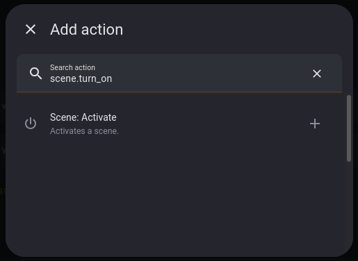

FWIW, if you just paste scene.turn_on in the “Add action” selector it will eliminate everything that doesn’t match. As shown below, searching for scene.turn_on returns the correct option i.e. “Scene: Activate”.

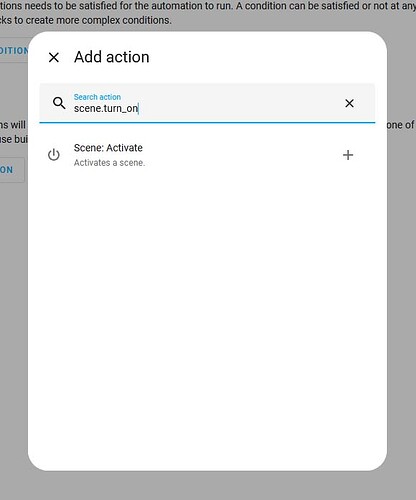

I wish my screen was the same
I’m up to date on everything, I think?..
scene3

Select Scene: Activate. That is scene.turn_on.
I discovered what I was doing. The following two, almost identical, actions were arrived at by…
  1. Click Add Action → type, “perform action” → select “scene: activate”.
  2. Click Add Action → type, “scene activate”
The former includes transition and the latter does not. It’s kind of puzzling, but that’s where I was messing up and got it confused with Scene: Apply (that also has transition).
