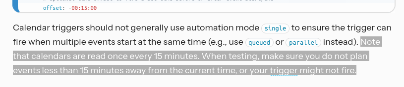

Beyond those structural issues, the most common reason why Calendar triggered automations don’t work during testing is the failure to follow the 15 minute rule:
I got it working.
My biggest issue was the 15-minute rule. Wasn’t firing.
