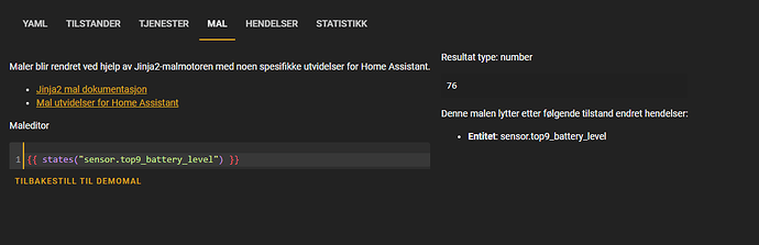

Cant get this to show my battery state.
Could you point out if you see some errors in my code?

Put this in your Developers tool → templates to see what you get…
{{ states(‘sensor.top9_battery_level’) }}
Plus I see you have this →
secondary: 'Battery Level: {{ states(''sensor.top9_battery_level'') }}%'
Should be:
secondary:  "Battery Level: {{ states('sensor.top9_battery_level') }}%"
You are using 2 single quotes instead of ", it’s showing you are using ’ ’ That will give you errors all day long.
There are several lines the same way… this will throw errors :slight_smile:
This happens:
The single quotes keeps coming back whenever i save the code. :stuck_out_tongue:
Still dosnt work when i change to double quotes.
Ok well that’s a start :slight_smile:
So I see by your template that it does read correctly, that’s good!
Lets keep looking…
