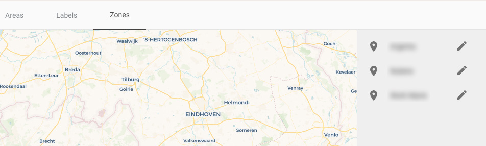

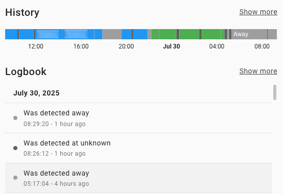

Lately I’ve been having an issue with person tracking within home assistant. Both me and my wife have Google Pixel phones, I checked the Troubleshooting | Home Assistant Companion Docs, and both my phone and my wife’s phone are set-up correctly.

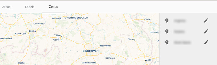

Now, there has been a second weird issue: my zone.home just disappears sometimes until I restart home assistant.
I’ll add some printscreens to show my issue.
What can I do to make this more reliable? As I can’t automate anything on this.

Your home zone is missing at times? You’ll need to fix that first. Are there any errors in the HA logs when that happens? I’ve never heard of the home zone disappearing
No, nothing in the log, this happens very occasionally though. The only thing I see in the log that has a direct link is the error in my printscreens…

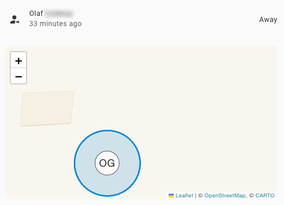

So, now both my wife and me are home, but are both shown ‘away’ although on the map we are in the blue ‘home’ zone circle
