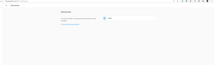

but I also have a “Person” called “Cédric”, the unique for now in HA.
Issue is that I can not find anywhere the account “mail address” in the HA configuration in the web interface. I would have expected to see this account being linked to “Cédric”, but can’t find anywhere this mail address.

Sorry but I do not have this … and in “Cedric”, I can not find the mail adress I use to log in …

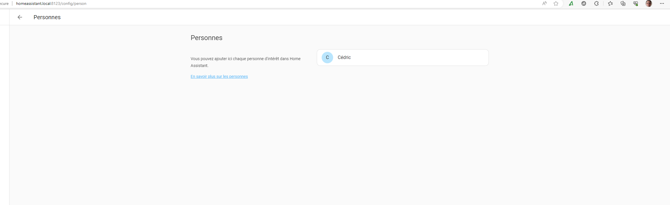

I am already in advance mode … but nowhere I see the mail assess I use to log in …
I found it was under Parameters → people, then indeed you have “People” and “Users”, and under users you can see the logins. Many Thanks !
