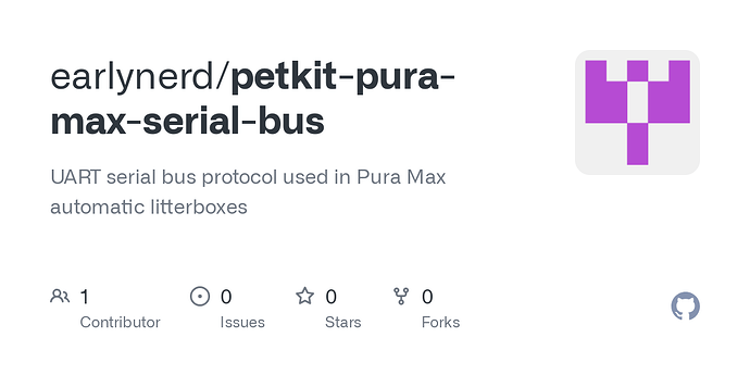

You can find flash dumps for both internal microcontrollers inside a pura max at my repo here:

Hello everyone, I stumbled upon this thread I opened a year ago, completely forgot about it. When trying to bring this project back to my todo list, I found this repo that looks promising. It’s not for the Pura Max 1 specifically, but as the maintainer said, it’s harmless to test if we have a backup of the current FW.
Here is the repo: Github repo
