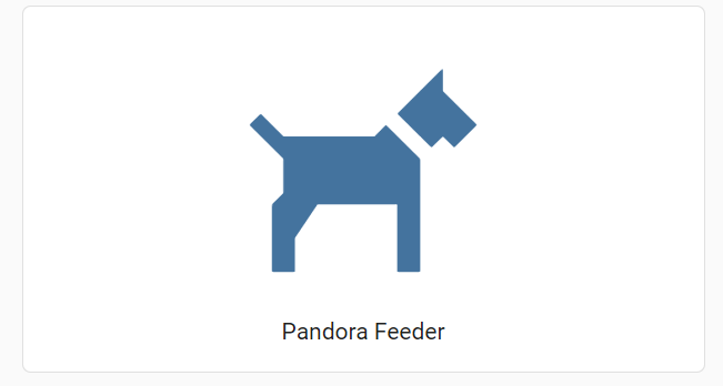

These instructions worked for me for the Petlibro feeder with no camera. The only thing I had to do extra, when I added the feeder I needed to add all the dp_id manually.
After the device was added I added the manual_feed which was dp_id: 3 for me, as a number with the following values.
  "unit": "",
  "min": 1,
  "max": 50,
  "scale": 0,
  "step": 1
Finally, I added it to my dashboard by creating a button that set the value to the manual feed.
