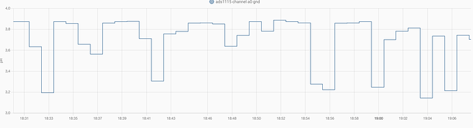

hi, I’m doing the same project but with ESP8266, in my case the voltage variation goes from 3,2v to 3,8v measuring in continuous, I don’t know if it is normal or not… Do you have the same variation? did you write the calibration to put as PH?

Fluctuation is only about 0,05 pH which is very accurate…
To be clear I’m using it with ESP32 and ADS1115 (with 0.1µF capacitor between GND and VCC as hinted above).
