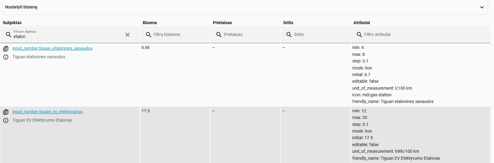

So I built a small package that produces one number in litres per 100 km: real fuel use plus electricity converted through a personal kWh→litre exchange rate (ref_ev / ref_fuel) that reflects how my car actually converts energy — n
ot a theoretical constant (conversion methods per E3S Web of Conferences 2021).
The trick: the two baselines behind that exchange rate are not static. After every trip over 10 km, an automation blends each trip’s real consumption into its baseline with an EMA of 90 % old + 10 % new, with sanity ranges so one glitch can’t poison them. The weight is fixed 0.10 on purpose — documented in code; 90/10 converged cleanly over months of testing.
relative = lifetime_fuel + lifetime_electric / (ref_ev / ref_fuel)
baseline = 0.9 × baseline + 0.1 × trip_value
Three components, no custom integrations: 2 × input_number baselines, 1 template sensor, 1 automation. Works with any integration reporting lifetime + last-trip consumption (VW Group via vag_connect-style entities, manufacturer clouds, OBD…).
