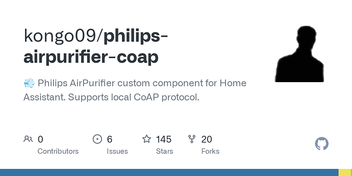

The integration GitHub - kongo09/philips-airpurifier-coap: 💨 Philips AirPurifier custom component for Home Assistant. Supports local CoAP protocol. (latest version .20 but same with older) does not auto discover but I can also not add manually and will come back with 'cannot connect to device ’
I have to tons of integrations running that connect to a local IP adress so I don’t think it is a network issue.
Any advice?
Please try to talk to the devices as described in the readme. Does that work?
