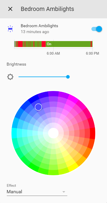

I have successfully created a custom light component for the Ambilights on Phillips Android TV’s (2016+) using the JointSpace API.
If you have already paired your TV for the philips_2016.py custom media_player component, you can skip the pairing process and refer to the same username and password in your configuration.yaml
Installation
First Pair your TV, and generate the username and password using this tool and enter the details, along with the IP address of your TV into your configuration.yaml as follows:
light:
  - platform: ambilights
    name: Bedroom Ambilights
    host: 192.168.1.XXX
    username: !secret philips_username
    password: !secret philips_password
Place the ambilights.py in you config/custom_components/light/ directory, and restart Home Assistant
Features
This component has the following features:
  • Power Ambilights ON/OFF
  • Brightness
  • RGB color
  • Effects
    • Manual (custom RGB color for all LED’s)
    • Standard (Follow Video)
    • Natural (Follow Video)
    • Football / Immersive (Follow Video)
    • Vivid (Follow Video)
    • Game (Follow Video)
    • Comfort (Follow Video)
    • Relax (Follow Video)
    • Lumina / Adaptive Brightness (Follow Audio)
    • Colora / Adaptive Color (Follow Audio)
    • Retro (Follow Audio)
    • Spectrum (Follow Audio)
    • Scanner (Follow Audio)
    • Rhythm (Follow Audio)
    • Party / Random (Follow Audio)
Individual effects can be easily removed from the Front-End by removing them from the AMBILIGHT_EFFECT_LIST (line 53 of ambilights.py )
