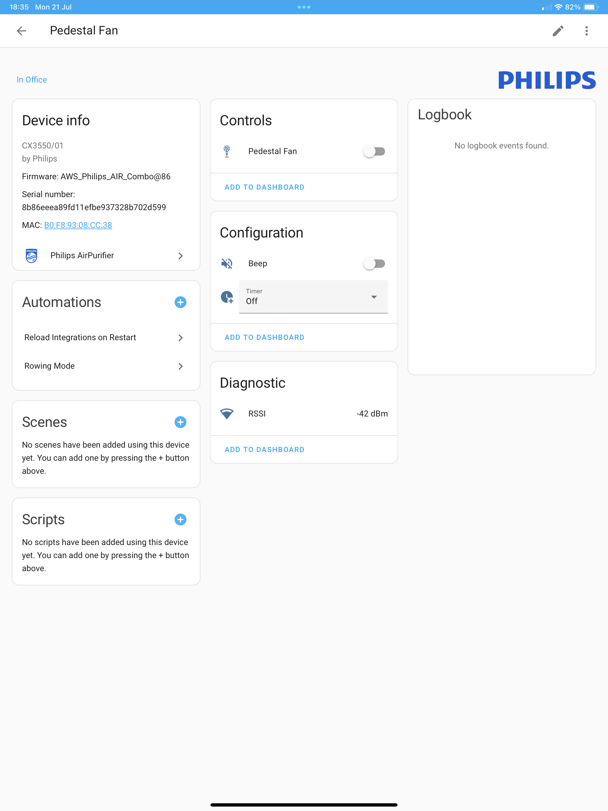

Hi everyone,
Iām new here, but I thought my solution might help someone, since Iāve seen people struggle with adding Philips fans to Home Assistant. Iāve tested this on two CX3550/01 units I bought today and it worked 4/4 times.
At first, nothing was working. I followed the guide on GitHub, but I kept getting constant timeouts when trying to add the device.
Turning the device on and off didnāt help.
I was getting frustrated, since I could ping the device from my Mac (so it was on the network), but the integration still refused to connect.
What Finally Worked - Hereās the trick:
Using the Advanced SSH & Web Terminal add-on in Home Assistant, I started pinging the device (CX3550/01) from the console and just left the ping running in the background.
Then, I went back to the Philips AirPurifier (CoAP) integration and tried adding the device again.
Boom! It worked.
I honestly couldnāt believe it was that simple. I stopped the ping, restarted the console, and tried the exact same trick with my second fan (which also wouldnāt connect before). Again, I started pinging it, manually added it to the integrationāand it connected right away. I repeated this for both fans, multiple times, and it worked every time.
So, in short:
Start pinging the fan from your Home Assistant terminal and leave it running, then add it to the integration.
No clue why it works, but it does!
Would love to hear if this helps anyone else. If you try it, let me know your results.
Amazing! Thanks for the information, I hadnāt revisited this since my enquiry last year. I still got the timeouts following your process, in addition I tried turning the fan on/off via the app and that seemed to make the HA Integration happy.
So happy to have this fan automation ready now. Thanks Again!!!

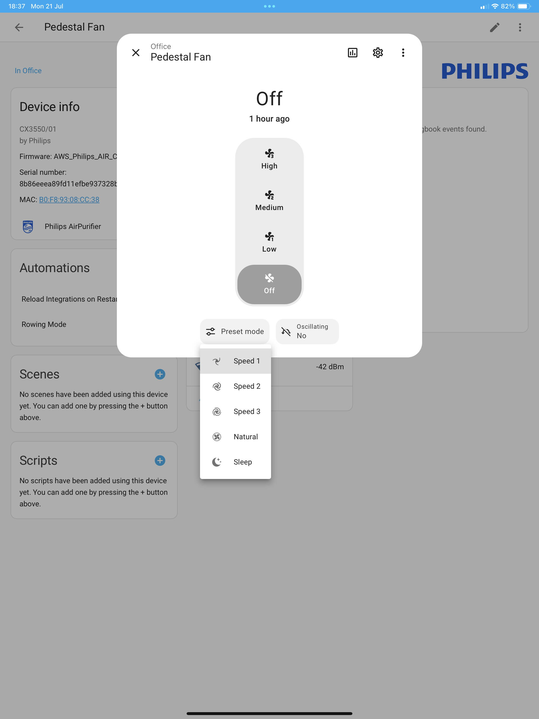

If you donāt mind me asking directly, for those of you who successfully integrated the Philips CX3550 into Home Assistant:
What exactly can you control? Can you switch between the individual preset modes?
