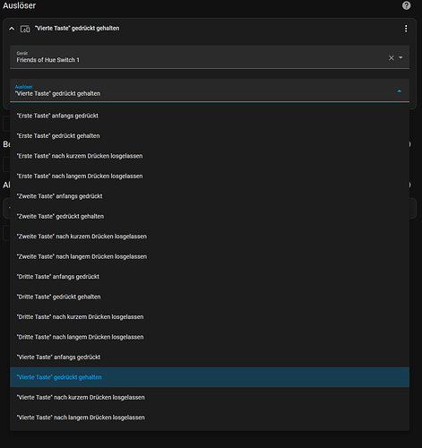

I just got a Senic + Gira Friends of Hue Switch and connected it to my philips hue bridge which is added to home assistant via the official integration.
When testing the events I stumbled upon the short press problem and so your post here.
There seems to be no event trigger for pressing both buttons (1+3 or 2+4 at the same time). Instead I get no event at all when in the home assistant when listening to hue_event and pressing them at the same time. One by one does work and gives me the subtypes 1-4.
eg:
Strange to me is that the Single Rocker feature (1+3 or 2+4) seems to be removed out of the philips hue integration.
At least it does not show me when setting up a automation
Altough it seems like this was the case (or maybe still is? Maybe im missing something?)
I found this video (7:27) where there have been the triggers “Both First and 3 Button released” as well as “Both First and 3 Button long released”.
But no Holding Button 1-4 Trigger
It seems like they have done a lot of changes in the philips hue integratin regarding the avaible events/triggers of Friend of Hue Buttons
Sorry for the screenshot as well as the video beeing german.
I hope you still get my point.
Agree, it is a earlier version which had the 1+3. So, we have to live with the current possibilities.
But why are they removing features :sleepy:
Would have been nice when using the single rocker option.
Probably gonna go with the double rocker then.
Nevertheless now gonna try out your blueprint. Thx for sharing and the quick response

Two questions:
  • Is there not real long press action available?
  • Added the Hass Sky Connect for Zigbee devices last week but it’s obvisouly not possible to pair a FoH toggle with Hass directly using ZHA and the Sky Connect. Any experience around?
In the first post the possibilities are mentioned, all covered by the blueprint. Unfortunately there is not an “even longer longrelease” or a “double click” which would also be nice.
I have not tried to connect my FoH switches to a native zigbee network. There are some post about this and they are supported using Zigbee2MQTT. Look in this link: EnOcean PTM 215Z control via MQTT | Zigbee2MQTT
Be aware the blueprint will not work, as it use Hue integration events, and not MQTT events.
