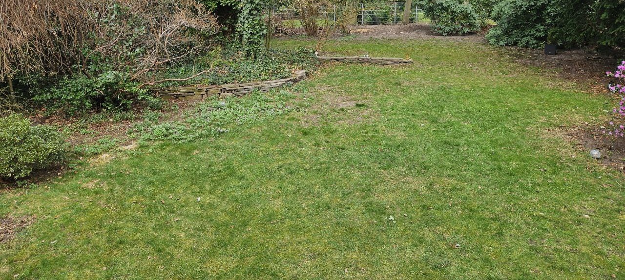

The sensor is mounted at a height of about 3 meters. This is what it “sees”.
At medium sensitivity level, the sensor is triggered whenever a bird lands or a cat wanders around.

What you might consider doing is mount another motion sensor further into this scene, and face it sideways or towards the other sensor. Group them, and only have them report when both are triggered. If another motion detector is too far away when mounted at that fencing in this scene, mount it on a pole or somesuch closer to the first motion sensor (within about 30 feet of each other should work, not sure how far one can push that).
