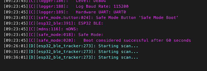

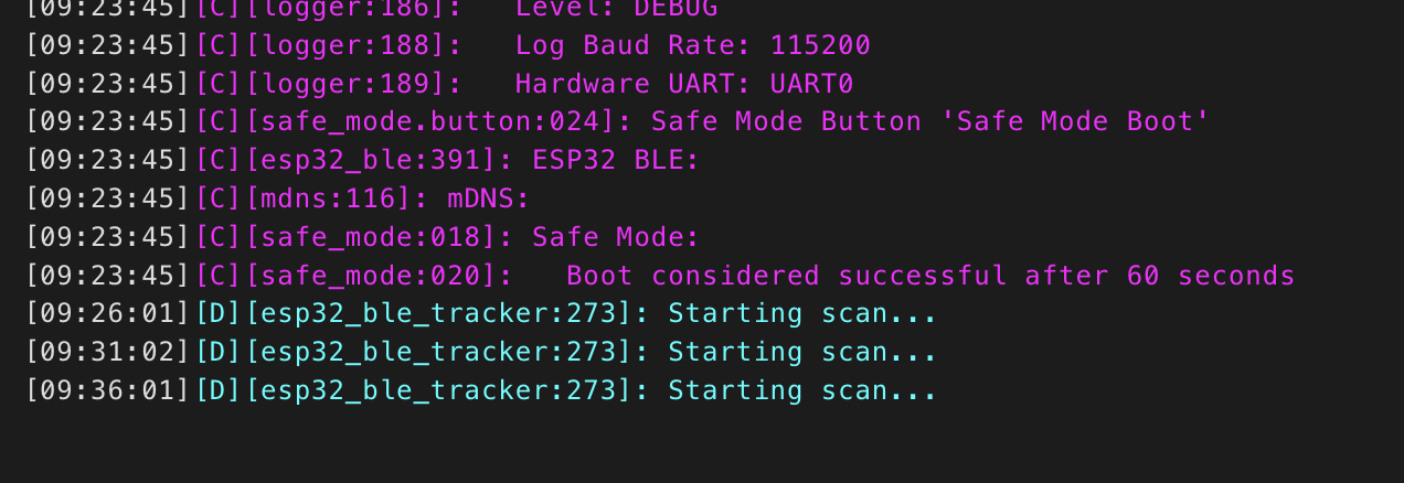

Having trouble getting this going. @EdwardTFN I’ve added your code to the config file and flashed the device. It validates in ESPHome and installs great. It’s added to Home Assistant and I see the new MAC address sense.
But it simply does not see Toothbrushes. I’ve even tried to just do a simple vanilla bluetooth proxy device with the added code. again. seems to work but never discovers the tooth brushes.
For what it’s worth, I’m using ESP32 WROOM-32 development boards from Aliexpress. Do I need to do anything extra to enable bluetooth on the esp32?
Thank you.
The code I’ve shared will only help on discovering your toothbrush Mac address, not connecting to the toothbrush, which requires the code suggested by @iamjosh here.
If you are not getting any mac address with my code, then try changing this line:
By this:
if (true) {
This will remove the filter for Philips and will show any device broadcasting in BLE. You may get a big list, but your toothbrush should be there.
Got the MAC addresses with @EdwardTFN’s but changing the one line in the code. Thanks!
