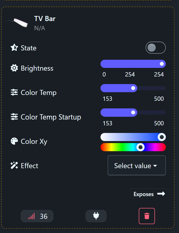

Well, I received the Hue Play Lights Yesterday.
I initially had an issue where Zigbee recognised the Play Lights but all of the Entities were Unavailable.
I was not aware that I had to Add a couple of lines to the Configuration.yaml file:
discovery:
  • philips_hue:*
Once this was done and Home Assistant was Restarted, All of the Entities showed up.
