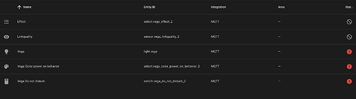

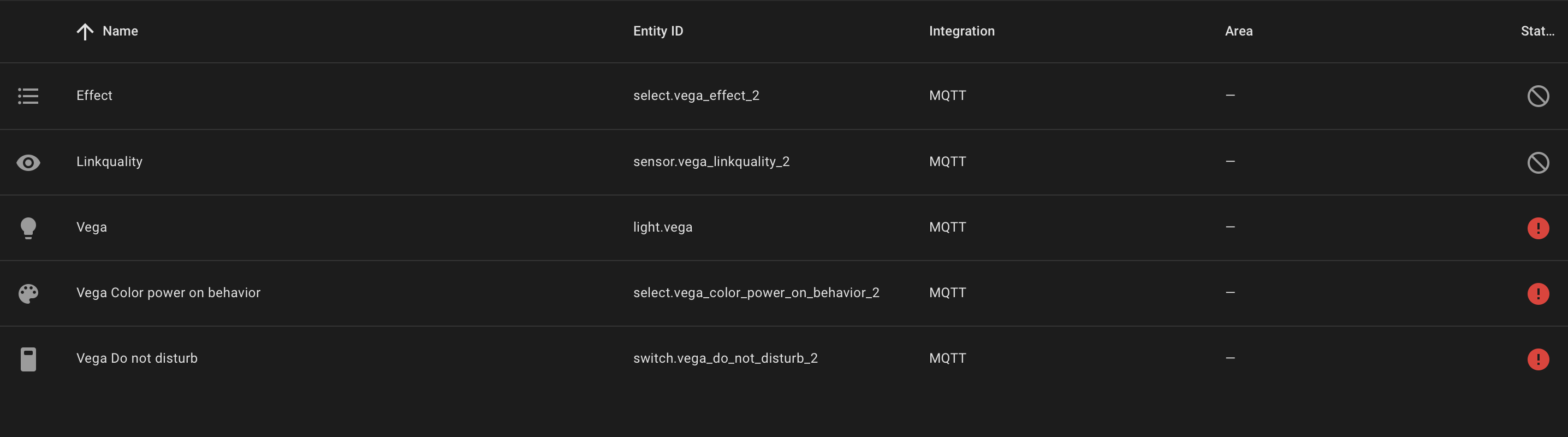

When I went to entities in home assistant it looked like this:
So I foolishly renamed the bulbs entity_id in home assistant. Which led to me having two (2) bulbs, one named light.vega and one called light.vega_2. No screenshot of that…

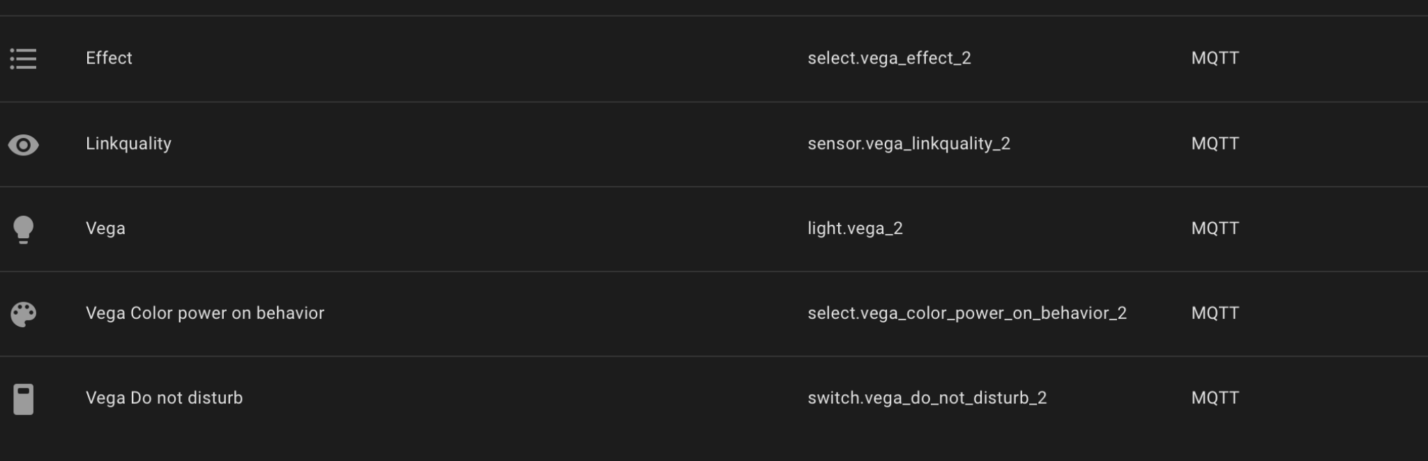

Starting up again the entities look like this:
Should I try to rename the remaining entities or just remove the bulb and start over?
The old bulb is removed from the scenes and I can live with that, I just want to learn how to go about this a better way for the remaining bulbs. Please explain it to me as if I’m five, I’m really doing my best to grasp this.
