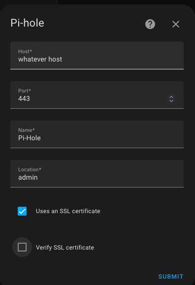

So, to get this working again. Version 6 uses HTTPS now. You’ll need to delete the app and add it again. Reconfigure it with HTTPS but don’t check verify SSL.
I did it with mine and I’m running the latest one and it is working.

I tried re-setting up with SSL as @astraeus-sirius said - it loaded my devices but all entities were unavailable.
