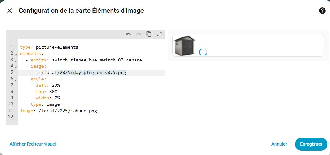

Picture-element, image not loading since 2025.11.0
Hi, since the update to 2025.110 (and also 2025.11.1), the image (not the small house, but just on the right side where we see the loading circle) is not loading anymore and the full navigation is now slow.
When I try to access directly to the URL the image is shown (http://192.168.14.66:8123/local/2025/dwy_plug_on_v0.5.png)
Any idea?
The “image” option is not a list.
Must be:
image: /local/...
You are wight, thanks a lot, it was probably accepted on earlier versions and now they cleaned up :wink:
