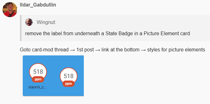

Goto card-mod thread → 1st post → link at the bottom → styles for picture elements

I would set here smth like “rgba(255,255,255,0.2)”, i.e. semi transparent.
That’s a great idea, but I have labels on my map and would make hard to read the temperatures
Hi @Ildar_Gabdullin, could you point me exactly to the piece of code to achieve that?
I’ve tried a lot, I’ve asked to ChatGPT, but nothing works, I cannot set the display to none for .title element …
Please do not, use brains. One person recently almost killed himself due to following AI advices from google (“what could be a replacement for a salt”).
Sorry, far away from a PC, cannot give a code. Please check examples given in the provided link.
What link are you talking about? Can’t find any link in your posts.
The post which you answered contains a path to a post.
I’m sorry this post doesn’t contain a link. “card-mod thread” is not a link, and there are a lot of card-mod threads when I search, sorry if I cannot find info.
