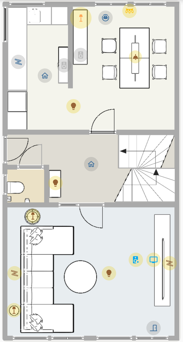

I now have a solution with card-mod:
  - type: state-icon
    entity: light.kitchen_table
    icon: mdi:ceiling-light
    style:
      top: 16.5%
      left: 74.7%
      transform: translate(-50%, -50%)
      width: 36px
      height: 36px
      display: flex
      align-items: center
      justify-content: center
      color: black
    card_mod:
      style: |
        :host {
          background-color: {% if is_state('light.kitchen_table', 'on') %}
            rgba(255, 255, 0, 0.4)
          {% else %}
            rgba(128, 128, 128, 0.25)
          {% endif %};
          border-radius: 50%;
For better visibility of the elements, here is the comparison with card-mod adjustment and without.
