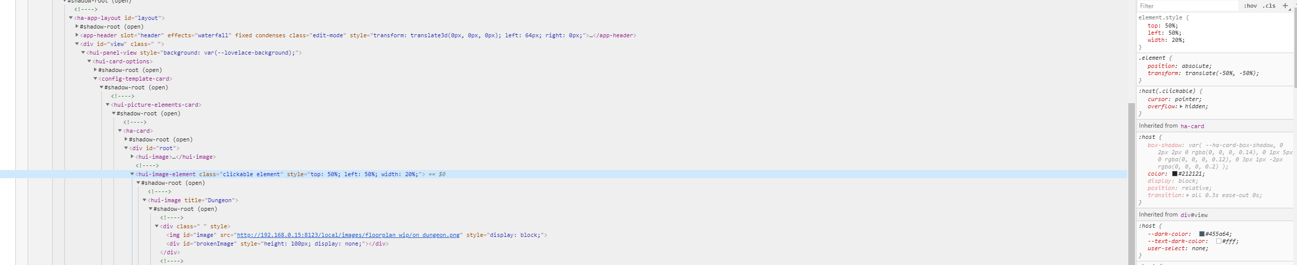

Edit:
Here you can see the applied attributes on the dev menu:
No, all you had to do was change your original codes var[0] to vars[0]. Now you’ve gone and changed a ton in other spots so other areas are broken.
