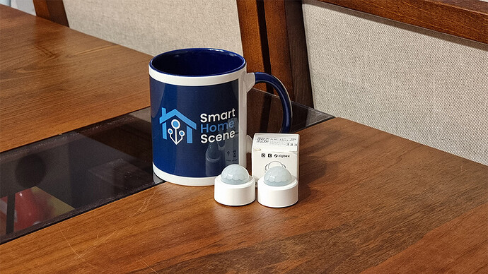

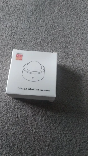

But the only way I know for now, the boxing is different. This version has a cubical box see https://smarthomescene.com/wp-content/uploads/2022/03/aubess-pir-motion-sensor.jpg.webp
And on the box they mention Model: ZG-204Z
And the one that is supported by ZHA, is a different boxing , see https://ae01.alicdn.com/kf/A84d473f173d44c2f86746e6b94f8ca6aB.jpg
