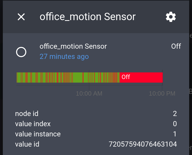

I’m using Ecolink Zwave motion sensors, which are PIR-based. I have been using one in the office for years to activate some lights and it always worked as expected.
Last week it started reporting false positives constantly - I thought it was hardware failure so I moved another identical sensor into the same room, and it also started reporting false positives. Thoroughly, confused, I moved both into a different room and now they’re back to normal. So something in the office, which 90% of the time has the door closed and no one in there, has started triggering the motion sensor as of last week.
To be clear, nothing in the office moves at all. So do I have a ghost in there or is there something else that could be causing a PIR sensor to detect motion when there is none?
The alternating green/red is when it is in the office; the solid red “off” is while in the other room.

I’d considered the same, but the sensor is pointed perfectly away from the window. Then I considered shadows… But this happens all night long as well in complete darkness. I am stumped!
