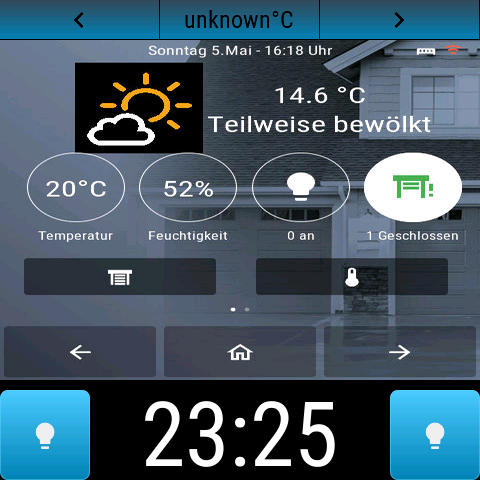

I’ve been struggling to get stuff working too. Had got HA to push images to the openHasp display. Went and fiddles with code to generate the image, and it stopped working. Following day, it started to work again. Not sure what I did, but hey…
Have you managed to send *.jpg files to the display via push? I’m trying to send a snapshot to the display of my Reolink cameras but it’s not working.
And another question… Send me the weather images via an automation to the display. this also works but I can’t get rid of the black background.
Can someone tell me how to get rid of it?

Note: You need camera on one of your lovelace cards, so don’t go hiding it. I might hack a component up to dish up images that are being regenerated on the fly (have some code spitting out sensor plots that I want to push to a plate). And if you are rescaling the image, take a look at this PR - PIL uses a width,height tuple for resize() and thumbnail(). by FreeBear-nc · Pull Request #121 · HASwitchPlate/openHASP-custom-component · GitHub
As for getting rid of the black background in the weather forecast images, dunno. The images I have (openhasp-weathericons-nigh.zip) are png format without a background colour so you’d need to play with the img attributes. I’m using a black background, so not an issue for me.
Many thanks.
Do I have to enter anything other than the IP of my HA instead of camera.local_file or entity_picture?
And how does it now generate the PNG file when the camera is moved? Where exactly does the path have to point to? Does it matter? I have an automation that automatically saves a snapshot of my Reolink camera in HA in a folder. However, I have seen that it is a JPG and not a PNG. According to OpenHASP, it only says PNG. Is this then a problem with a JPG file and therefore did not work?
I don’t quite understand that yet either. Do I have to have a camera entity somewhere on my dashboard for the camera from which I want the snapshot?
Yes, I’ve already tried all that. But the black background remains. I have no idea what else it could be.

It is perhaps also important to mention that if I select the source for the weather image directly from the display, i.e. via L: etc., it is then without a black background.
Only since I have activated an automation that sends the images for the weather to the Dsiplay via push to image when the weather changes have the backgrounds been black.
Sorry, not going to quote the whole post…
Camera image - You would need to look at your camera entity (Developer Tools->States) and see what the image attribute points to.
I’m not sure if openHASP supports JPG format. If not, you’d need to use convert or mogrify to convert on the fly (is it possible to run a shell command from inside HA ?) - If not, it could be done with a pyscript (please don’t ask me how, I’m not that well up on python).
Lovelace card - You need to have the camera showing somewhere on your dashboard. Otherwise, the automation doesn’t have a valid URL to push the image over to openHASP.
Finally - Weather icons on a black background. It sounds like you have discovered the source of the problem. They display correctly if accessed from L: on the plate, but not if you use push_image. The quick & simple answer is to store the images on the plate, and reference them from your automations as per examples. With 16M of flash storage, you’re not going to use up that much space.
Yes, you can push a jpg image to a plate and it will display.
upload
This is the part of the automation that is responsible for the images. How can I change this automation so that it selects the images from the display itself (L: …)? Unfortunately, I’m not a professional enough to know how to rewrite it :frowning:

And to be honest, I still don’t understand why it makes the black background via push to image and not via the display of locally stored files. Is there an explanation for this?
openhasp.push_image seems poorly documented. In the source it says
description: URL or Full Path of an image
So maybe you can use L:/image.png (hopefully with templating) instead of the URL you are using back to homeassistant. In fact this is specified in the docs for the image object
{“page”:1,“id”:34,“obj”:“img”,“src”:“L:/image.png”,“auto_size”:0,“w”:50}
Also, you have a problem with the image background. Can you post one of the images here? Perhaps you need an image with a transparent background.
Lastly have you tried fiddling with the object background? See Styling Properties - openHASP
These are the standard images from the OpenHASP website for the weather in the night variant.
https://www.openhasp.com/0.7.0/assets/users/openhasp-weathericons-nigh.zip
I tried it with the normal styling options like “bg_opa”: 0 etc. But I don’t quite understand the parts yet and don’t know how I would have to adjust/add this to my weather icon to try it. See my code:
 "SEITE 1 - WETTER - IMAGE",
                "page": 1,
                "id": 14,
                "parentid": 2,
                "obj": "img",
                "src": "L:/openhasp_dummy_img.png",
                "bg_opa": 0,
                "auto_size": 1,
                "pad_top": 10,
                "pad_bottom": 10,
                "pad_left": 10,
                "pad_right": 10,
                "tollge": "false",
                "action": "p2"

Can you also tell me how I should customize my automation so that it reads the images from the display itself instead of via push image? Unfortunately I’m too dumb for that.
Using L:image.png works for me. I just lifted the code from Example Configurations - openHASP and plugged it in to my openhasp.yaml.
    - obj: "p1b84" # Forecast condition
      properties:
        "src": >
          {%- if not is_state('weather.forecast_home','unavailable') %}
          L:/z-32-{{ state_attr('weather.forecast_home','forecast')[2]['condition'] }}.png
          {%- endif %}
It just works, and no need to run it as an automation.
