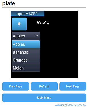

I got one of these today, but reading this thread has me confused. Some posts different displays. Should the instructions in Post#2 be enough to get me started?
Better Front
Openhasp setup is probably better described in the docs, but post 2 is a very good summary, and has the jinja template as an added bonus.
I would appreciate some guidance, please.
I followed the steps in post #2, and this is where I am at:
20240602_000327-480
This is in my configuration.yaml:
#---------- OpenHASP ----------#
openhasp:
  plate:
    objects:
      - obj: "p0b1"  # temperature label on all pages
        properties:
          "text": '{{ states("sensor.attic_sensors_temperature") }}°F'
      - obj: "p1b2"  # light-switch toggle button
        properties:
          "val": '{{ 1 if states("switch.officelight") == "on" else 0 }}'
          "text": '{{ "\uE6E8" if is_state("switch.officelight", "on") else "\uE335" | e }}'
        event:
          "up":
            - service: homeassistant.toggle
              entity_id: "switch.officelight"
The light button changes on the screen when it is touched, but the light never toggles.
Also- I am not seeing any MQTT messages on MQTT Explorer.
What did I miss?

Fiddling with pages.jsonl gave me this:
Thanks for the tip.
I used the example in the openHASP Custom Component, substituting my entities. And since this is the only plate, I kept the name as “plate”.
But I think the non-responsiveness of the button is because MQTT is not connecting? Running MQTT Explorer, I don’t see any MQTT traffic to or from the plate.
