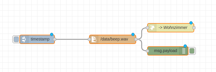

Oh, wow, that would have been the easiest way because I’m already using Rhasspy, but I didn’t try it out because the documentation says that I need to POST the contents of the WAV file:
Well, the documentation isn’t really clear… I struggle with it !
You can POST, as I proposed, but you mustn’t set Content-Type to audio/wav
The only thing you have to do is to post a string starting with “/”, then the wav file from that path will be played (so the file should be on the filesystem of Rhasspy, this is the reason why i mount this in Rhasspy’s container: -v /var/lib/docker/volumes/Media/_data:/profiles/Media \
