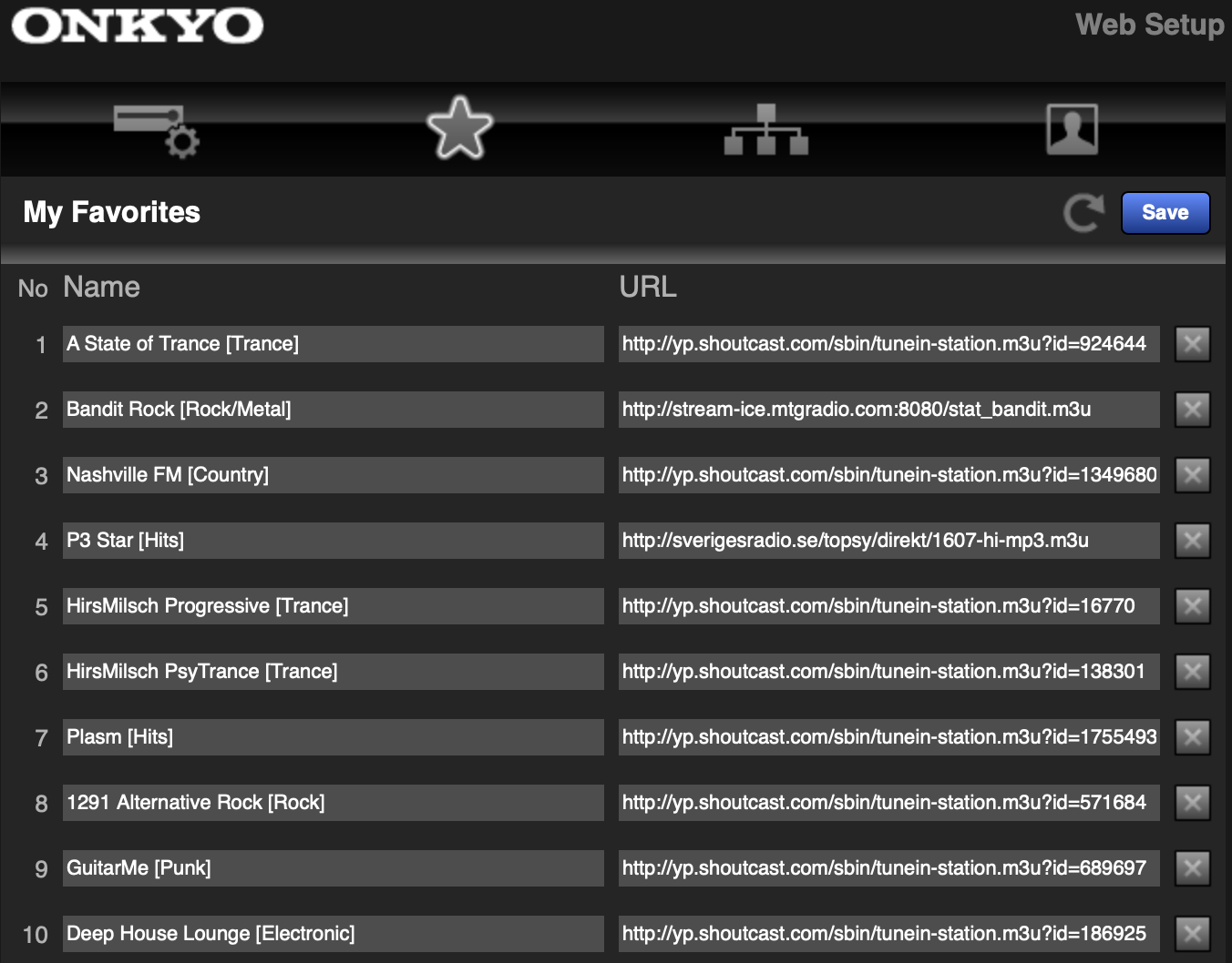

The internet stations are indeed .m3u files
The presets on the Onkyo web UI are corresponding to the presets in the shell_command.

aha ok, you put me on right track , seems on VTuner, thats the online portal for internet radio stations for denon receivers, i can add there manual m3u links , those will shop up on my favorites!!
yeah, solved!
although i am limited to 4 favorites as memory presets, but my actual favorites list is longer, like your presets

myObject['save.y'] = '1'
#print( myObject )
print( 'send fovorite list to onkyo' );
x = requests.post( onkyo_url, data = myObject )
# turn onky on
# set volume 11
# set on source: net
# set channel on first favorite ( this is the new favorite )
#sometimes the call to recevier times-out, so try every call  max 3 times....
receiver = eiscp.eISCP( onkyo_ip )
i = 1
while i < 3:
  try:
    print( i )
    print( receiver.command('power on' ) )
    break;
  except:
    i+=1
i = 1
while i < 3:
  try:
    print( receiver.command('volume 11' ) )
    break;
  except:
    i+=1
i = 1
while i < 3:
  try:
    print( i )
    print( receiver.command('input-selector net' ) )
    break;
  except:
    i+=1
i = 1
while i < 3:
  try:
    print( i )
    print( receiver.command('dock.internet-radio-preset=1') )
    break;
  except:
    i+=1
receiver.disconnect()
print( 'restore original favorites' )
myObject[ 'name00' ] = lsName
myObject[ 'url00' ] = lrURL
print('and send the original list to onkyo' )
