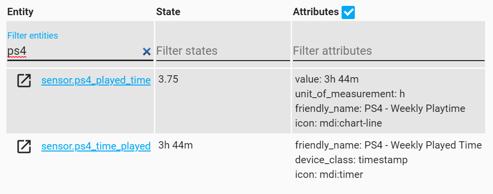

When I look up the entities, they show up how I would expect…

I can click on the entity in the UI and it shows the proper time format.
I’m at a loss as to why all the sudden this changed after the last update to HA but that’s when it started to load oddly.

Remove the device_class: timestamp from the template sensor.
I have the same sensor that works, and adding the class to it, shows the same behavior.
You the man! That did the trick! Thank you very much!
