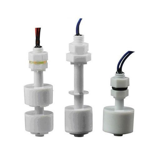

don’t use a moist sensor those dont really work well for your application , try using float sensor like this one

I am using a Tuya Water Leak Detector Zigbee device from Amazon. It has worked perfectly so far. Unfortunately the Bird bath is pretty small, 24" in diameter and only 3" deep so a float sensor wouldn’t easily fit.

theres is a really small float sensors
like this one
is actually a push button so you automation is really simple if is open turn on else turn off and thats it

That is so tiny. Thank you very much for the link.
