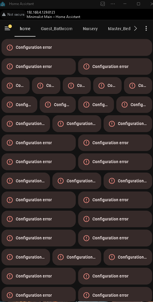

Please Help Configuration error, working fine for 2 years
I’m hoping somebody can help me in a way I can understand. I had some time off 2 years ago when my wife was ready to give birth and I created this dashboard. It has worked flawlessly for 2 years now, but a month ago it quit working and i no longer have any clue how to work on Yaml and with the toddler, I don’t have time to relearn. I used to use it every day and it’s been down a month I’m just now getting the opportunity to reach out for help. I’ve tried restoring previous builds and reverting updates. It’s simply took a crap.
![Screenshot 2025-06-22 092234|252x500],(upload://6mba1WYCdU0JVyiCO6IZxOOLP7Q.png)
. Can anybody help

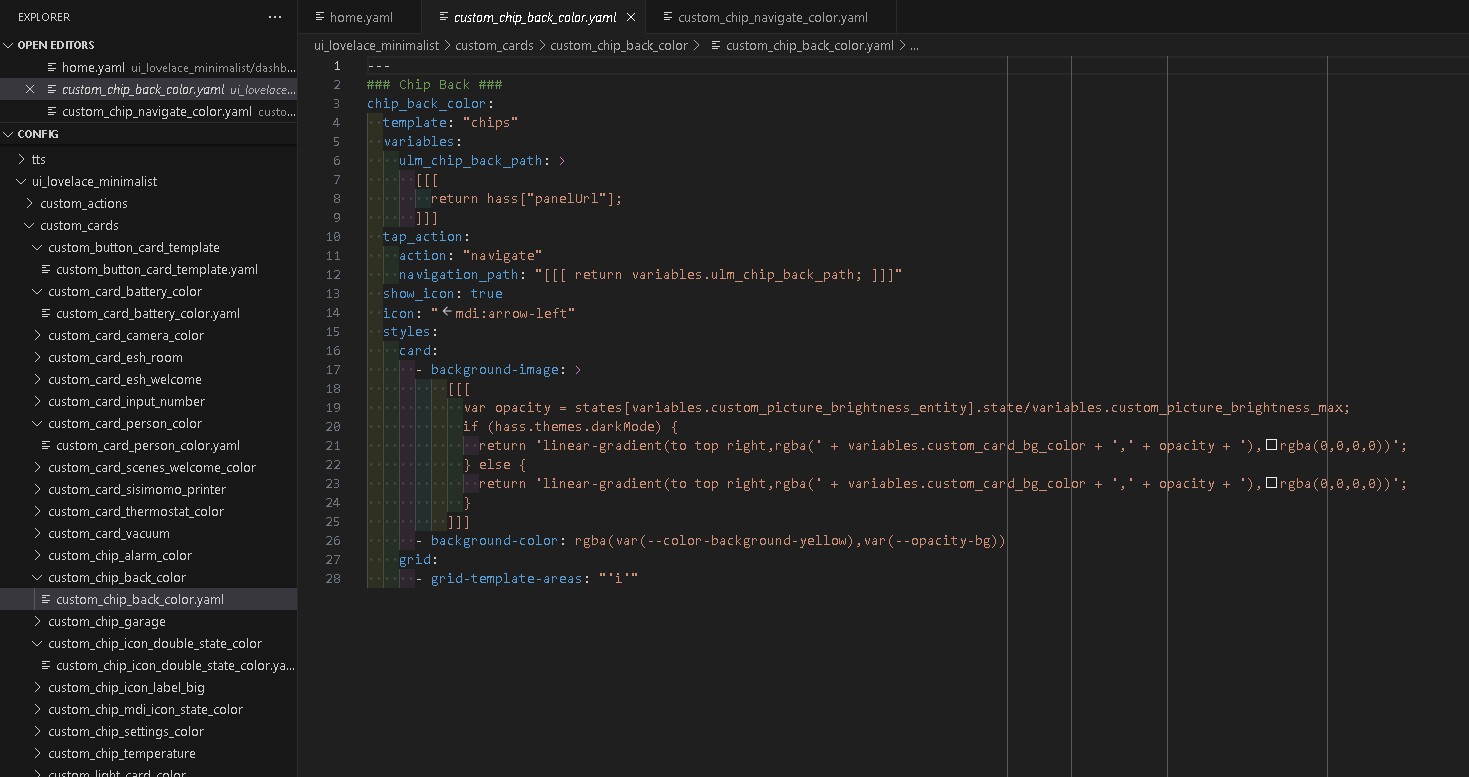

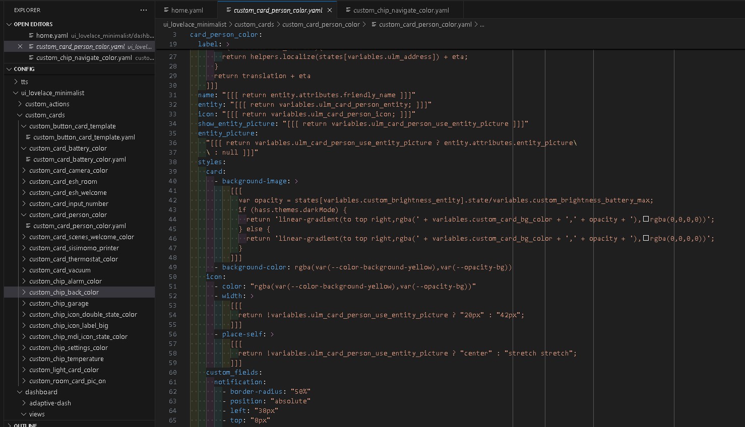

…<5 lines>…
) from err
ValueError: Sensor sensor.weather_outside_temperature has device class ‘temperature’, state class ‘measurement’ unit ‘°F’ and suggested precision ‘None’ thus indicating it has a numeric value; however, it has the non-numeric value: ‘weather.forecast_home’ (<class ‘str’>)
2025-06-22 09:59:14.847 WARNING (Recorder) [homeassistant.components.recorder.migration] The database is about to upgrade from schema version 47 to 50
2025-06-22 09:59:14.848 WARNING (Recorder) [homeassistant.components.recorder.migration] Upgrading recorder db schema to version 48
2025-06-22 09:59:14.894 WARNING (Recorder) [homeassistant.components.recorder.migration] Upgrade to version 48 done
2025-06-22 09:59:14.895 WARNING (Recorder) [homeassistant.components.recorder.migration] Upgrading recorder db schema to version 49
2025-06-22 09:59:14.895 WARNING (Recorder) [homeassistant.components.recorder.migration] Adding columns mean_type to table statistics_meta. Note: this may take several minutes on large databases and slow machines. Please be patient!
2025-06-22 09:59:14.908 WARNING (Recorder) [homeassistant.components.recorder.migration] Adding columns mean_weight to table statistics. Note: this may take several minutes on large databases and slow machines. Please be patient!
2025-06-22 09:59:14.925 WARNING (Recorder) [homeassistant.components.recorder.migration] Adding columns mean_weight to table statistics_short_term. Note: this may take several minutes on large databases and slow machines. Please be patient!
2025-06-22 09:59:15.022 WARNING (Recorder) [homeassistant.components.recorder.migration] Upgrade to version 49 done
2025-06-22 09:59:15.022 WARNING (Recorder) [homeassistant.components.recorder.migration] Upgrading recorder db schema to version 50
2025-06-22 09:59:15.055 WARNING (Recorder) [homeassistant.components.recorder.migration] Upgrade to version 50 done
Logger: homeassistant.setup
Source: setup.py:279
First occurred: 9:58:01 AM (1 occurrence)
Last logged: 9:58:01 AM
Setup failed for custom integration ‘ui_lovelace_minimalist’: Requirements for ui_lovelace_minimalist not found: [‘aiofiles==0.8.0’].
Minimalist - could be the issue. I usually do not recommend anyone use it.
Of course other reasons could be there.
Make sure you are running updates versions of HA and HAOS (or your OS and ałl libraries, if you are running another installation).

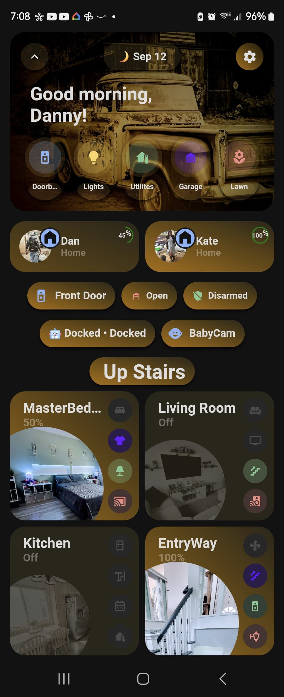

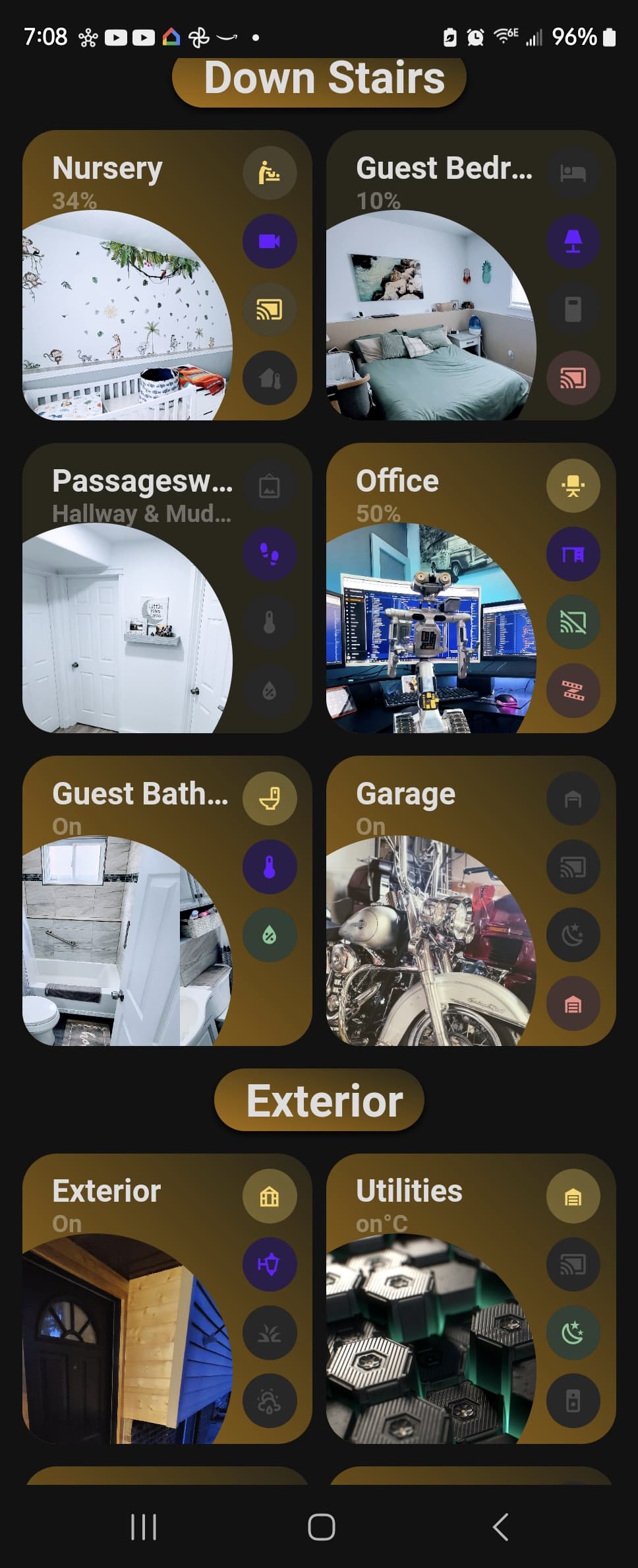

Okay, hopefully you’re still around. So I got it working (don’t remember how) and a few months later I lost the 2 chip cards you see in the Right Image (Left Image is how it should look). They are a custom_chip_navigate_color. I inserted code into all my cards and renamed them custom_chip/card_xxx_color. I did this to get the same color as the room cards when brightness is at 100% to get the goldish yellow. It is based off a custom brightness etc. Well Chip_navigate_color doesn’t seem to exist anymore and when I add it, it doesn’t work and it disapears after a restart. I know it would probably be easy if I could remember anything, but I really don’t remember how I did everything, I’ve got ADHD, I went in got super zoned in and focused on this task, built it and now 2 years later its mostly gibberish to me. The screenshot of custom chip back color is to show an example of the “color” functioning
