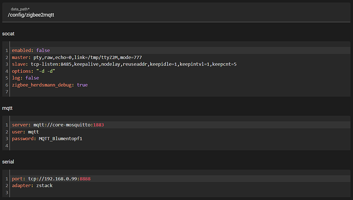

My configuration.yaml:
homeassistant: true
advanced:
network_key:
- 114
- 113
- 58
- 237
- 249
- 179
- 10
- 83
- 155
- 16
- 222
- 211
- 50
- 120
- 153
- 251
pan_id: 5631
ext_pan_id:
- 181
- 173
- 164
- 178
- 251
- 58
- 146
- 104
channel: 11
mqtt:
server: mqtt://192.168.0.178:1883
user: mqtt-user
password: mqtt-password
serial:
port: tcp://192.168.0.99:8888
adapter: zstack
frontend: true

I tried this procedure: https://community.home-assistant.io/t/zigbee2mqtt-502-bad-gateway-solved/447571?u=elmbob
- deleted the PAN ID, extended PAN ID and network key and wrote GENERATE instead. With the next restart new keys where generated, according to Running Zigbee2MQTT and ZHA together - #11 by Zwaantje
