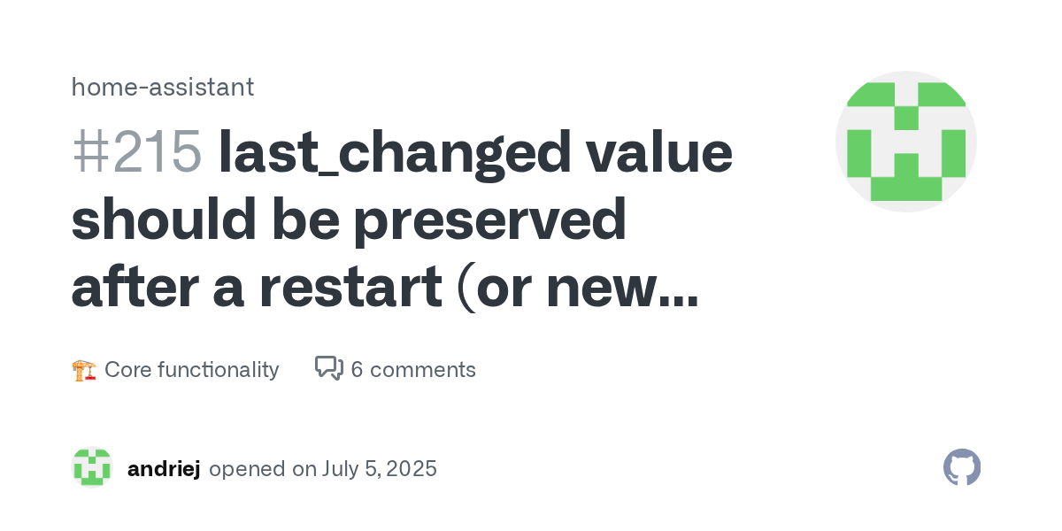

PLEASE vote to get Last Changed & Last Updated FIXED
PLEASE go vote for this... even if you dont know what this is, trust those of us who create add-ons and blueprints... This Is Needed and causes a huge problem with standard logic when the system restarts (even if only part of the system restarts).
Summary: At HA restart (YAML reload), HA wipes these values and replaces it with the restart time of the system... really bad design, not a single good thing about it.
There have been dozens people, over multiple years, posting on this forum and others have asked the core devs to fix this (yes fix - this is a design flaw 100%)
An nice dev built an add-on as a work-around but its shameful this is even necessary.
PLEASE GO VOTE --- thank you!

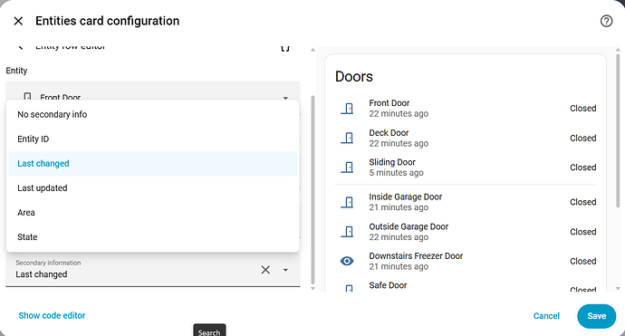

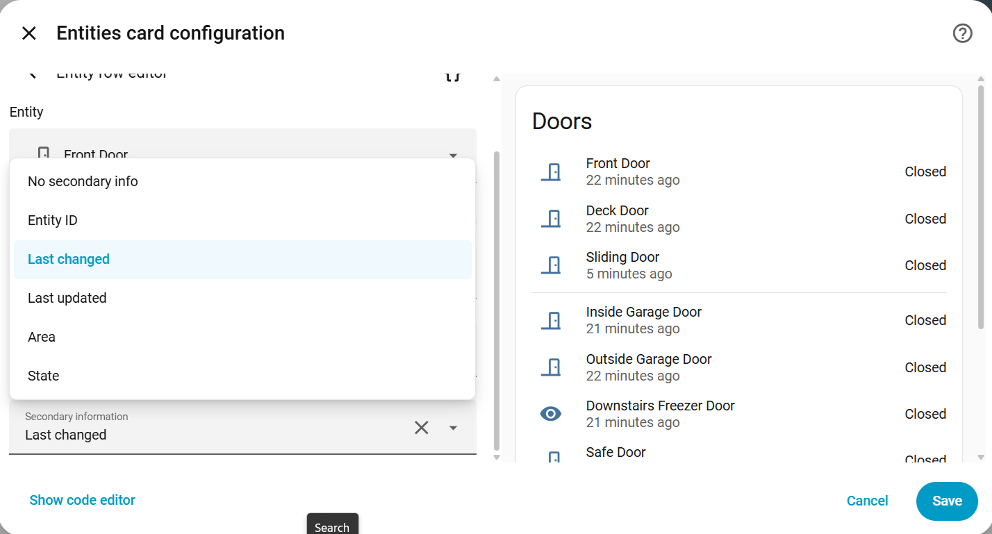

I can see the last_reported in the Template Editor, but not as an attribute in Developer Tools - States, and it's not available as a secondary attribute in an Entities Card. Will these be updated to include it?
You have been told it already exists yet go on and on. Why don't you switch to using last_reported and stop the rant? If last_changed is altered to do the same as last_reported, then it is a huge breaking change to remove something that has its uses too, leaving us with two identical timestamps. Just get used to the other name for it.
