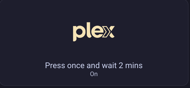

  • Add a wake and shutdown button to HA.
  • ToDo : When Smart Hub TV tries to start Plex, start the plex server
Based on input from Guide: Start up and shut down remote linux PC using Home Assistant – Creating Smart Home
show_icon: true
type: button
entity: switch.remotepc_2
icon: phu:plex
show_state: true
icon_height: 100px
name: Press once and wait 2 mins
