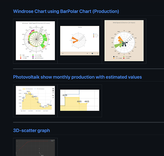

Hello community!
I added an index of discussions with images so you can find examples more easily.
Click on the Index of examples with images in the readme
When you are done, would you make a Show&Tell post in the discussions?
I bet there’s other people trying to do the same thing that will thank you for it ![]()
