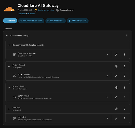

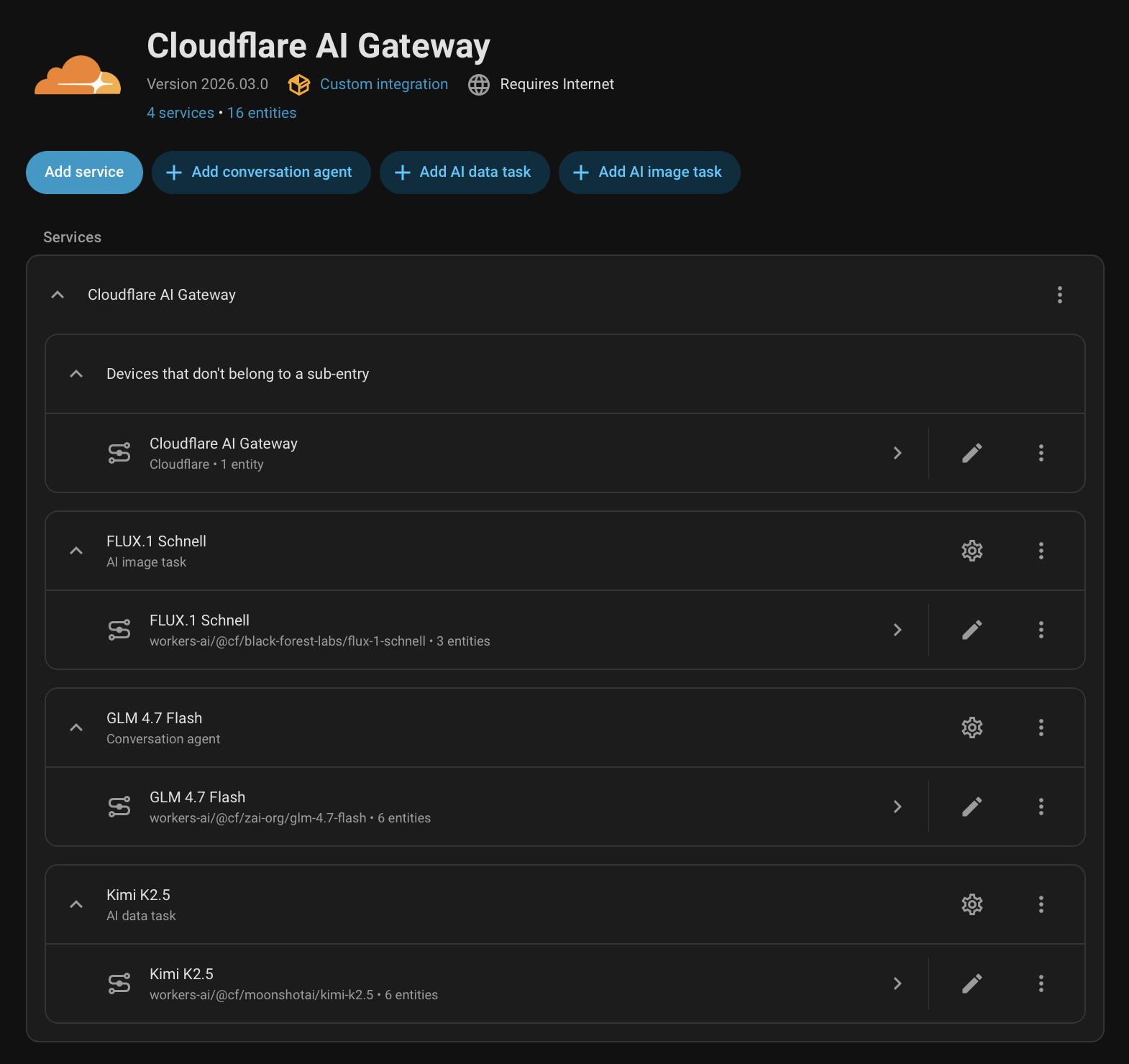

Full setup guide + model recommendations on gitHub: michaeldwan/ha-cloudflare-ai-gateway
What you get

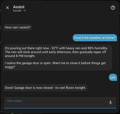

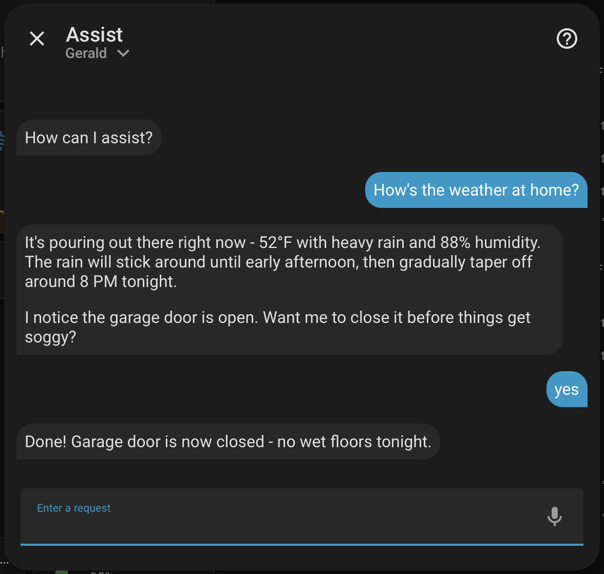

  • Chat models become conversation agents with tool calling and streaming, plus AI task entities
  • Image models (Flux, Stable Diffusion) for on-demand generation
  • Usage sensors per model – requests, tokens, cache hits, errors
  • Cost tracking via Cloudflare’s analytics – use HA automations to cut off spending when you hit a threshold
  • Spend limits, rate limiting, guardrails, and more in the Cloudflare dashboard
