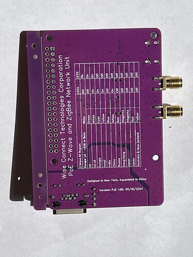

 This is our newly designed the most advanced Smart controller for telecommunication operator, Electric or Nature Gas Company or/and for commercial, residence users. It supports HomeSeer and Home Assistant.
The PoE part provide the power for this product. It is active PoE with maximum 30W. This product consumes power less than 1 watt. The input volage is between 36-57V. with the 4 pin input, it also works for 12V DC. The SoC 3.3V and 1.8V is also DC-DC switching power to improve efficiency.
The FPGA part provide TCP/UDP encapsulating and communicating with Z-Wave 800 controller and ZigBee 3.0 coordinator.
Z-Wave 800 SiP provide Z-Wave Controller with proper firmware and with impedance matching to RF antenna. The SMA external antenna provide 3dBi gain. The firmware is written using C code.
ZigBee 3.0 SiP provide ZigBee and multiple protocol coordinator with proper firmware and with impedance matching to RF antenna. The antenna provide 5dBi gain.
