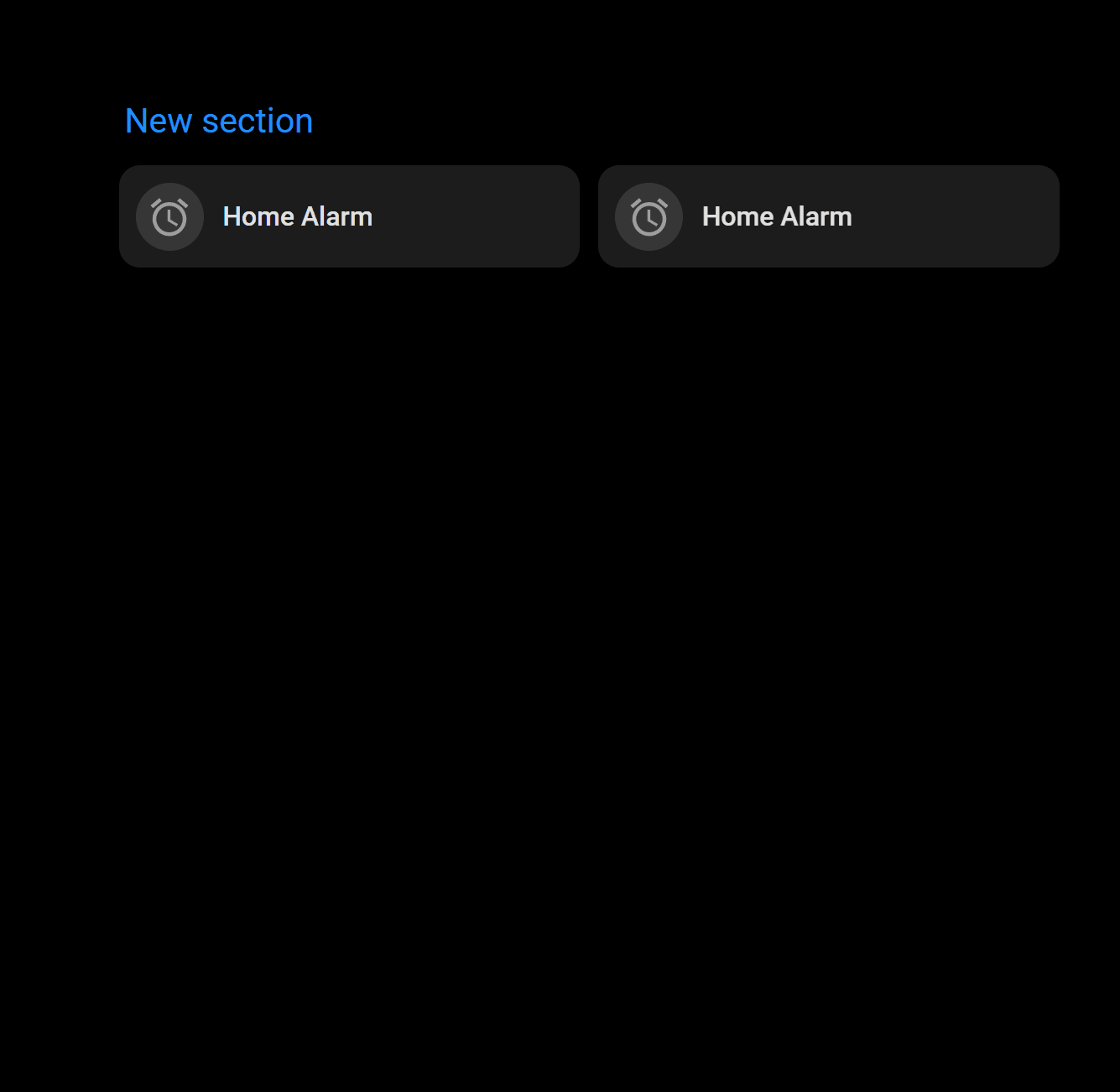

Here is an example of the icon opacity dimmed when the boolean is on
example
Yes, I did use opacity: 0.5 !important; under [role="button"] and it doesn’t work. I added it under ha-card to make it work
