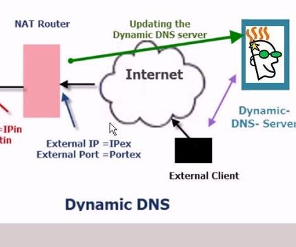

As others have mentioned, DuckDNS solves the problem of having to manually update your GoDaddy A record IP address when it changes. I didn’t want to use DuckDNS so I wrote a script to update my A records using the GoDaddy API.
Nice! I’ve been toying with doing something with a GoDaddy domain name I have lying around anyway. It never occurred to me to check to see if GoDaddy had an API I could use. Any chance we could see your script?
There is a really good tutorial @ instructables including a bash or PowerShell script.
Take a look here:
The PowerShell script in the link @paddy0174 posted is what I used as a starting point. My script does everything there but adds logging and a push notification with the new IP. I used the Home Assistant API for the push notification.
