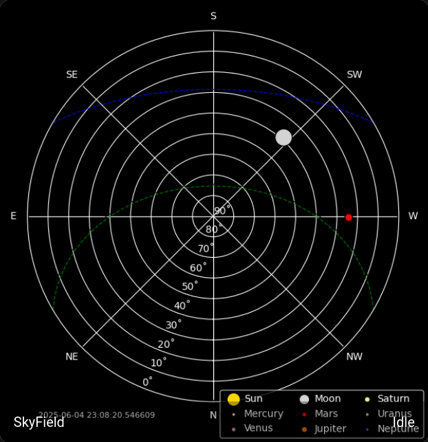

But what does the log say?
What hardware are you running on. This is very cpu intensive.
Hey Nick, thanks for quick response.
I’m running hassio on RPI4-64 4GB, using 12% cpu prior to enabling this integration.
What do you mean the config isn’t yaml? Instructions say to add it to Config.
No log entry for this, as I’m able to add in the camera code to config, but when I Check Config prior to reboot it never completes the check… circle just keeps spinning.
I do see 2 seperate log errors when I initially installed the integration: “Error while processing template”, and “TemplateError”. Both have fairly long report logs.
–deleted–
That error is coming from something completely different. Fix your template.
Oops, your right, that log has nothing to do with this. I forgot the night before I added in a Compass integration I was playing around with.
Regardless, it passes yaml check, so this still doesnt help me fix the issue with THIS integration and that it won’t pass the yaml check.

Newby to HA. Thanks for this great repo for us space junkies. Is it possible to get the image in dark mode? This will be great when used in the evening when stargazing.
Is there a dark mode available for the picture?
Will there be a fix for the problem with the „ Entity not available: camera.skyfield“ after the HA Update and the error with the matplotlib that is a dependency and can’t be installed anymore?
GitHub Issue #26 has some techniques for dark mode. It involves editting one of the files in the custom component. I think the results are pretty. Here is my one line change: plt.style.use('dark_background') in bodies.py

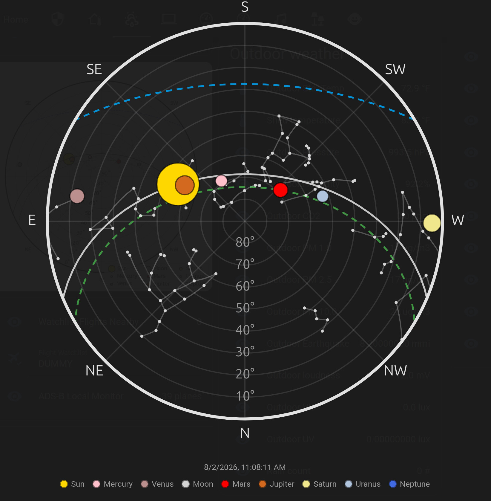

Hi, I’ve really enjoyed this integration in the past, but never overcame the issues with the HA Updates. I had an idea today and whipped it up. Basically, I’ve offloaded the plot generation to a webserver and I’m showing the image on the dashboard. It’s great to have the plot back again. If you are interested in using what I did, check it out here: GitHub - larryjmoore/skyfield_web: See the apparent positions of the Sun, Moon, and planets. Great to display in Home Assistant..
I made a big update to the integration today that adds an optional browser-rendered SVG mode that looks great in dark mode. Additionally, I highly optimized the calculation so it uses something like 1000x less CPU.

You’re right there was still an issue with matplotlib. I’ve now fully removed that dependency and it should work out of the box on HACS now and even has UI config now. Thanks for trying it out.
