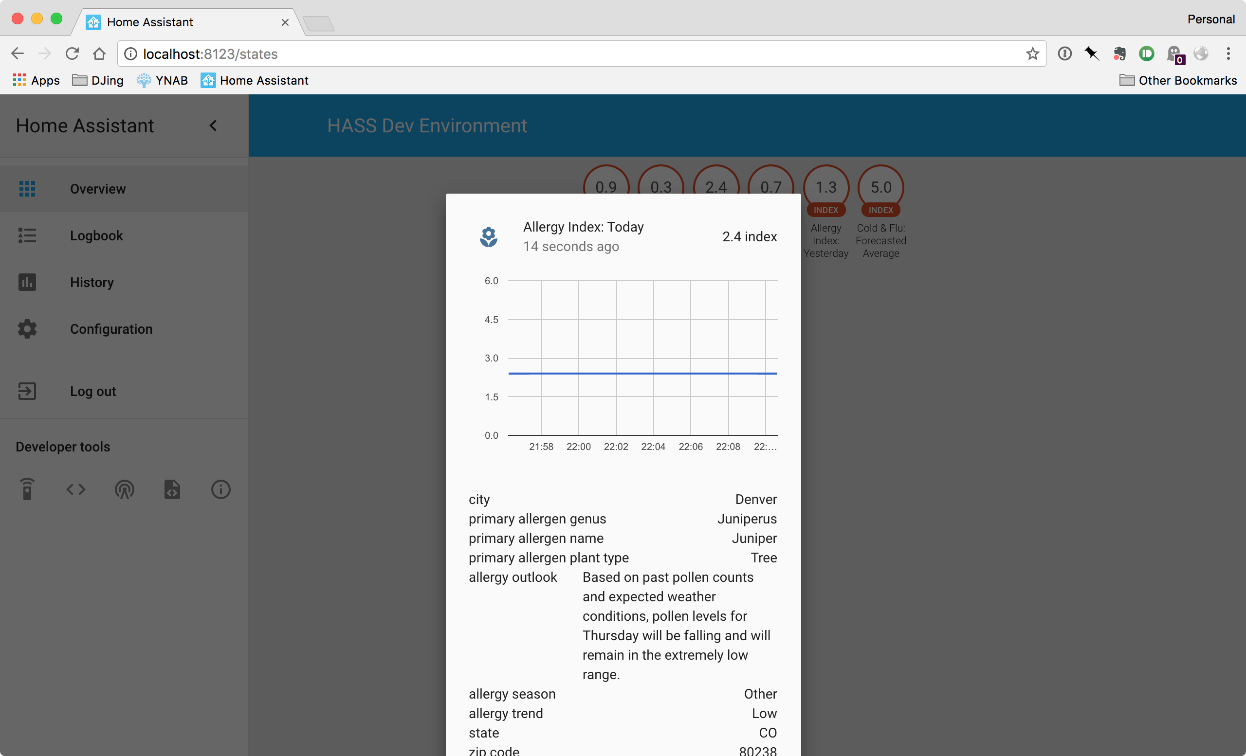

Alrighty, folks – making great progress: I have the base platform in place. Will submit an official PR tomorrow; in the meantime, enjoy some screenshots!
Alrighty: PR completed and submitted. PRs:

Indeed! To put a list together, here’s a quick list of the sensors and attributes the platform produces:
- Allergy Index: Forecasted Average
- Allergy Index: Historical Average
- Allergy Index: Today
- Allergen Genus
- Allergen Name
- Allergen Type
- Outlook
- Season
- Trend
- City
- State
- ZIP Code
- Rating (e.g., “Low/Medium”)
- Allergy Index: Tomorrow
- Allergen Genus
- Allergen Name
- Allergen Type
- Outlook
- Season
- Trend
- City
- State
- ZIP Code
- Allergy Index: Yesterday
- Allergen Genus
- Allergen Name
- Allergen Type
- Outlook
- Season
- Trend
- City
- State
- ZIP Code
- Cold & Flu: Forecasted Average
- Trend
- City
- State
- ZIP Code
Keeping the majority of data as attributes keeps the base implementation slim and allows for access of that data via template sensors.
