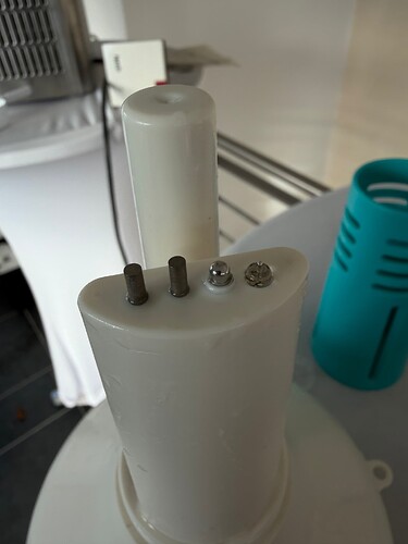

I am running it with tuya gateway and xZetsubou Local Tuya integration. It is still the best option as you can manage/calibrate the device in Tuya App and it is working without any connection issues. Yellow device is highly preferred because of probes upgrade. On the blue one rusts ORP probe and stops working.

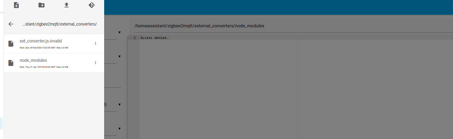

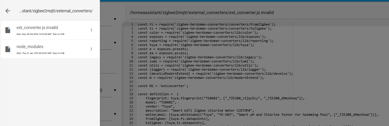

Which version of zigbee2mqtt are you using? I have tried to add the external converter as you suggested and I keep getting the “ext_converter.js” file renamed ext_converter.js.invalid when I restart zigbee2mqtt. I am guessing it is an older version as the external converters are now in the data directory.

This is the old one. Yellow is the upgraded version. It is not working with ZHA yet. Local Tuya is still the best solution to get correct values.

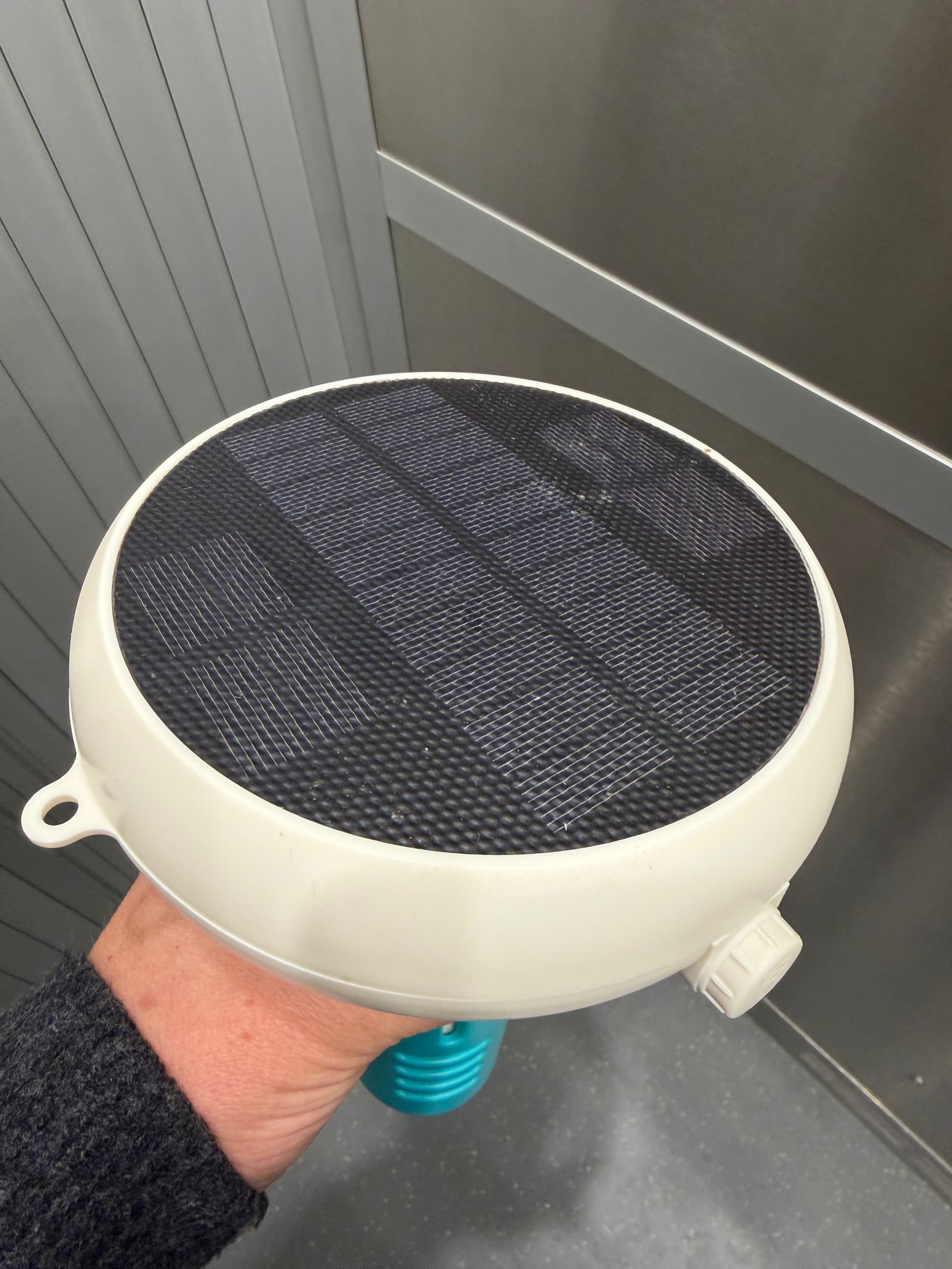

On the lower end, which one is the new version? As I have purchased the blue one but find that my solar panel looks like the one one your yellow unit, just curious about the sensors…
Probes look like on the yellow one, seems to be also upgraded.
That’s what I thought, thanks for your thoughts :slight_smile:

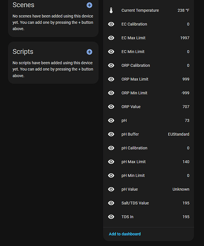

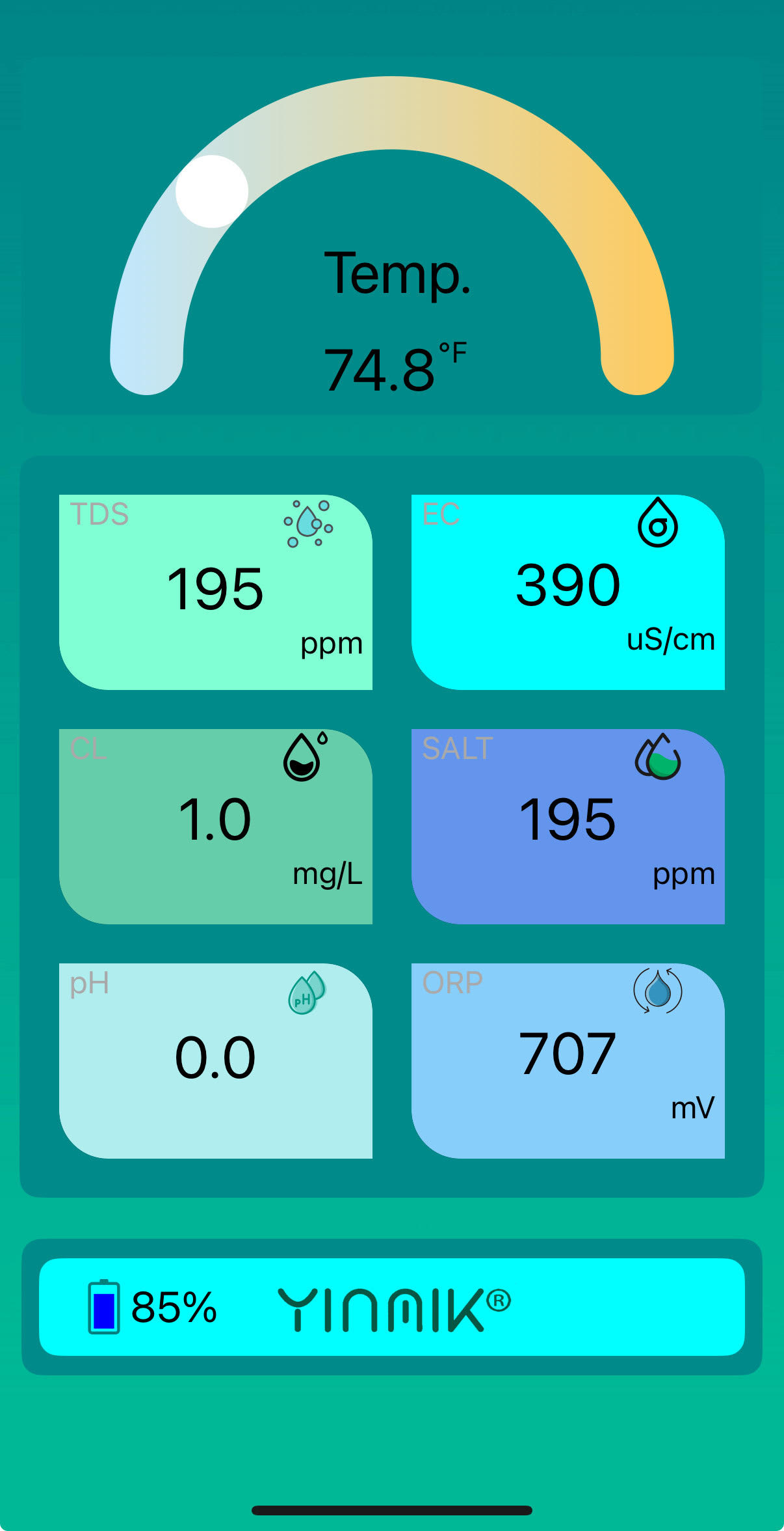

I recently bought the red GIDIGI 7-in-1 Pool Monitor, and everything seems to work fine, but the pH. Whenever I pull the data using LocalTuya, I get two different pH sensors, labeled “pH” and “pH Value”. Is there an explanation for why it is not showing up in the app and why I have two different pH sensors?
Is the external converter a hardware component or a corresponding piece of code? Is there any more information about it?
Hi xvolte,I followed your description, but it doesn’t work. What am I doing wrong? Can you please help me? I’m using Zigbee2Mqtt 2.8.0. The interface is different now. Regards, Harry
